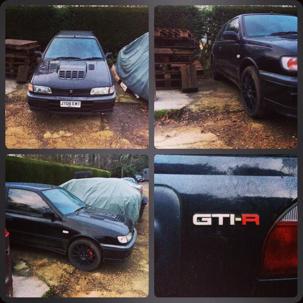

so I picked up little baby a few months ago, a bit of a deal it was. Trading work for the car worked out pretty well.
previous work on the car which the receipts show are....
it it had a full engine rebuild by a chap down in south end, the company name escapes me but he's a specialist? His name was bob . The invoice shows forged pistons rods bolts new shells ect arp bolts new oil pump and other bits, it had a hybrid turbo to but that has since failed and been replaced with a standard unit.. Well that's a brief history I don't know some one might recognize it...
well so now I have it

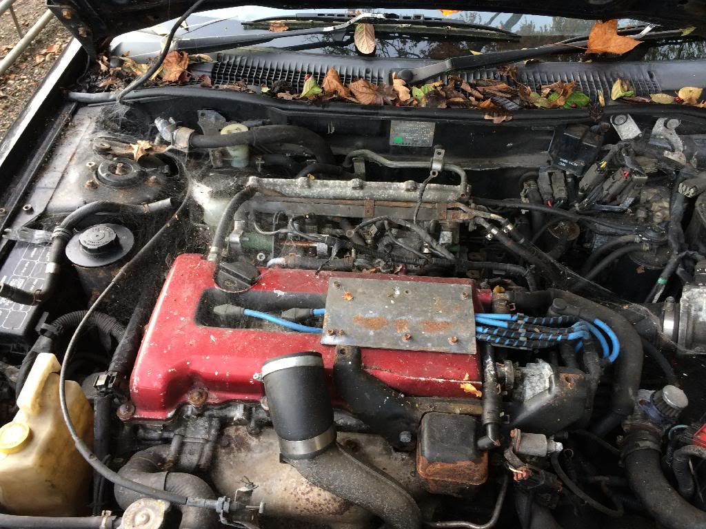

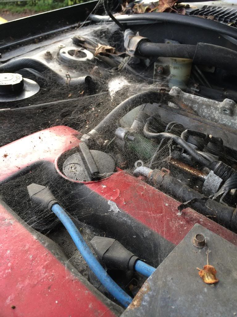

And there it sat for a few days... Finally I got some time to lift the bonnet and well it looked a little sorry for its self!
my first pulsar might as well go for all the forums... B651C18D-061C-4D38-BDA7-F1983F3509E6_zps3vuxln4b
my first pulsar might as well go for all the forums... 1D769132-FD9F-40EA-AF62-6431A29628D2_zps8vlhtgzw
the spiders web was so thick it was like a blanket.. It just peeled off in one big sheet needless to say it had sat for 2 years under a tree and had some hash work done to it... I'm not even sure what they was doing..
The IACV had been repaired.. But on closer inspection I noticed that the plug was glued on the opposite way round? Pit wasn't squared and just looked like a lash job.. Repaired that and re fitted with a new gasket.

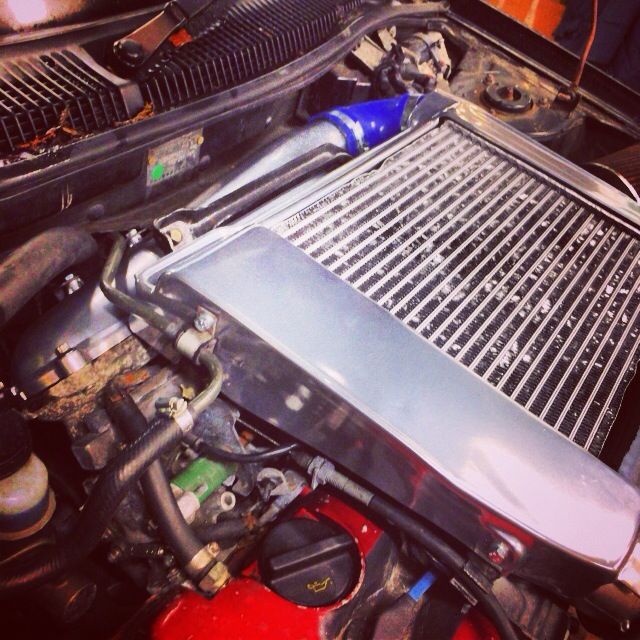

so I thought why not get some bits painted to look nice so the plenum lid and the inter cooler cover were first to go!
my first pulsar might as well go for all the forums... 1BD233EB-BAA3-4F8A-B6C0-80C9E40C9988_zpsc8kplzad
Parts all refitted and it was time to see if it started.... Amazingly it started on the button! Ran a little lumpy and then cleared!

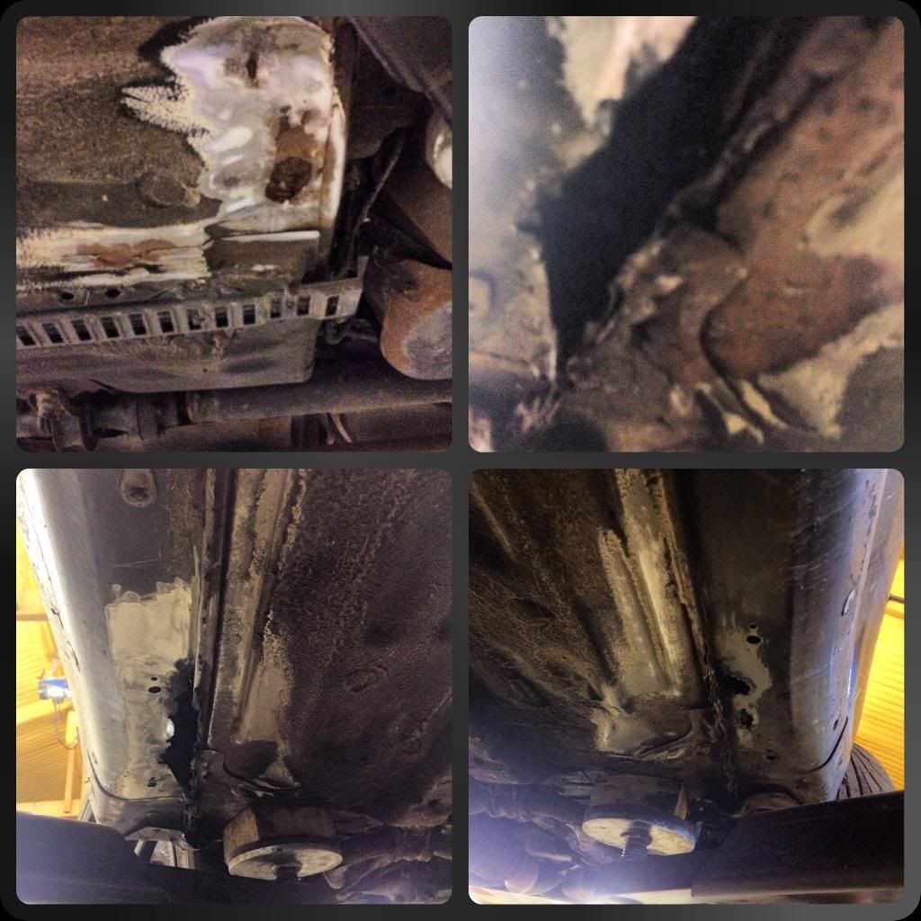

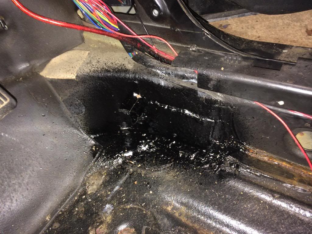

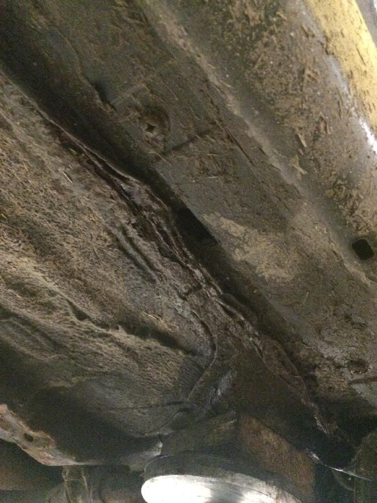

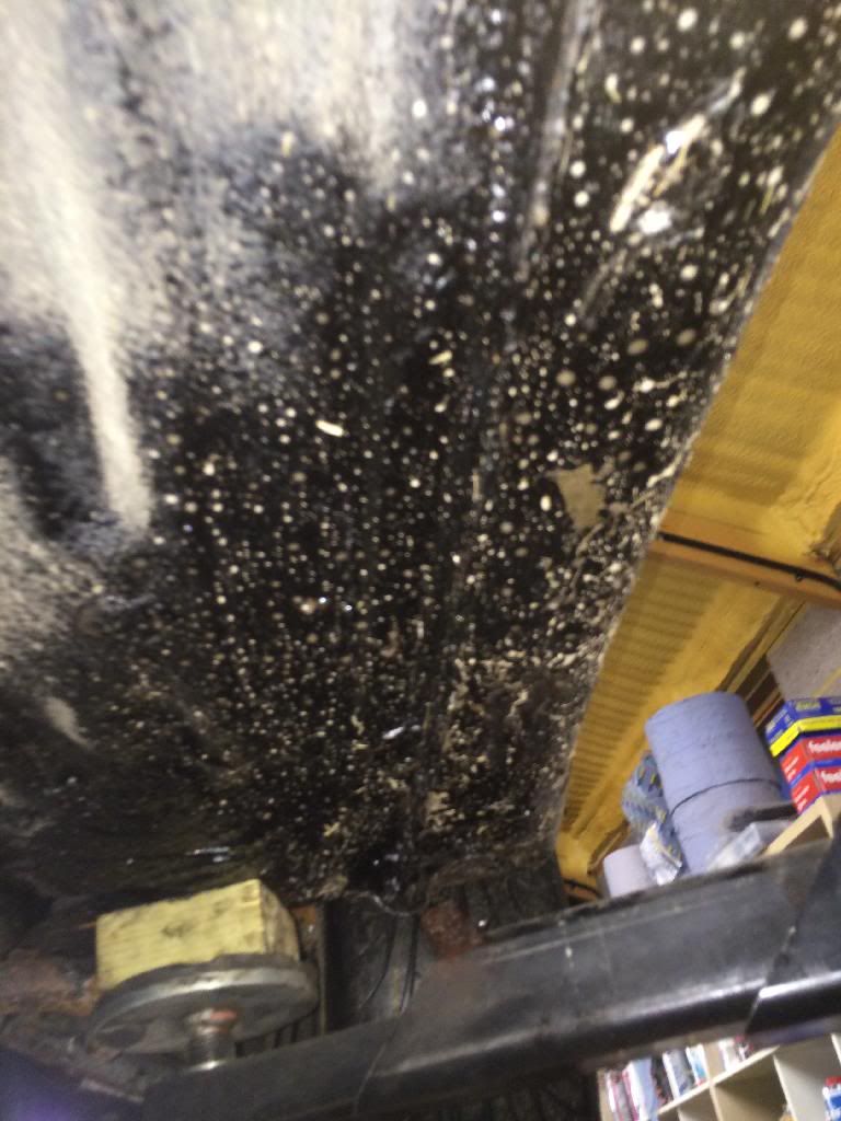

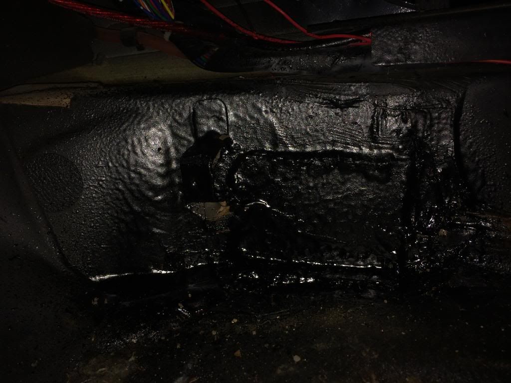

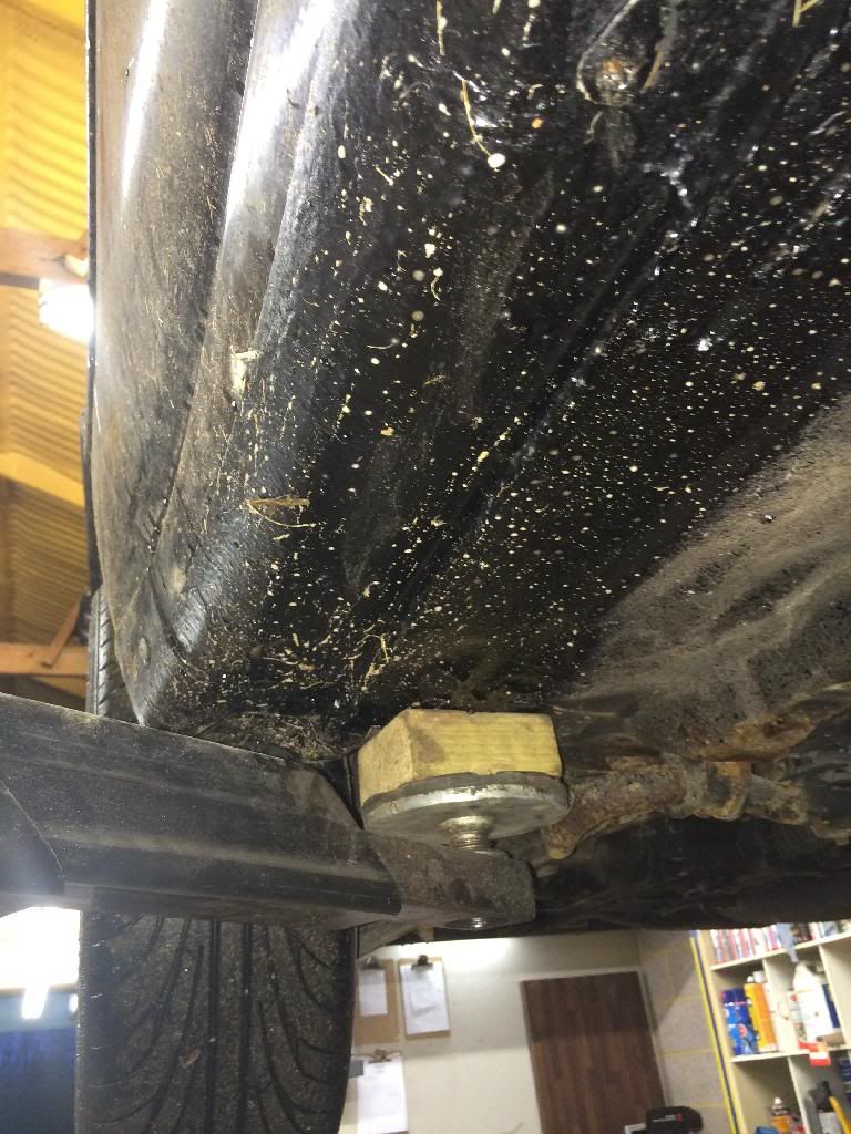

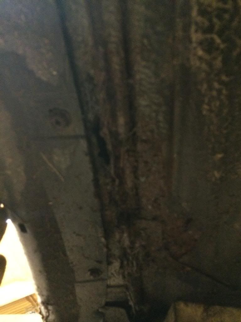

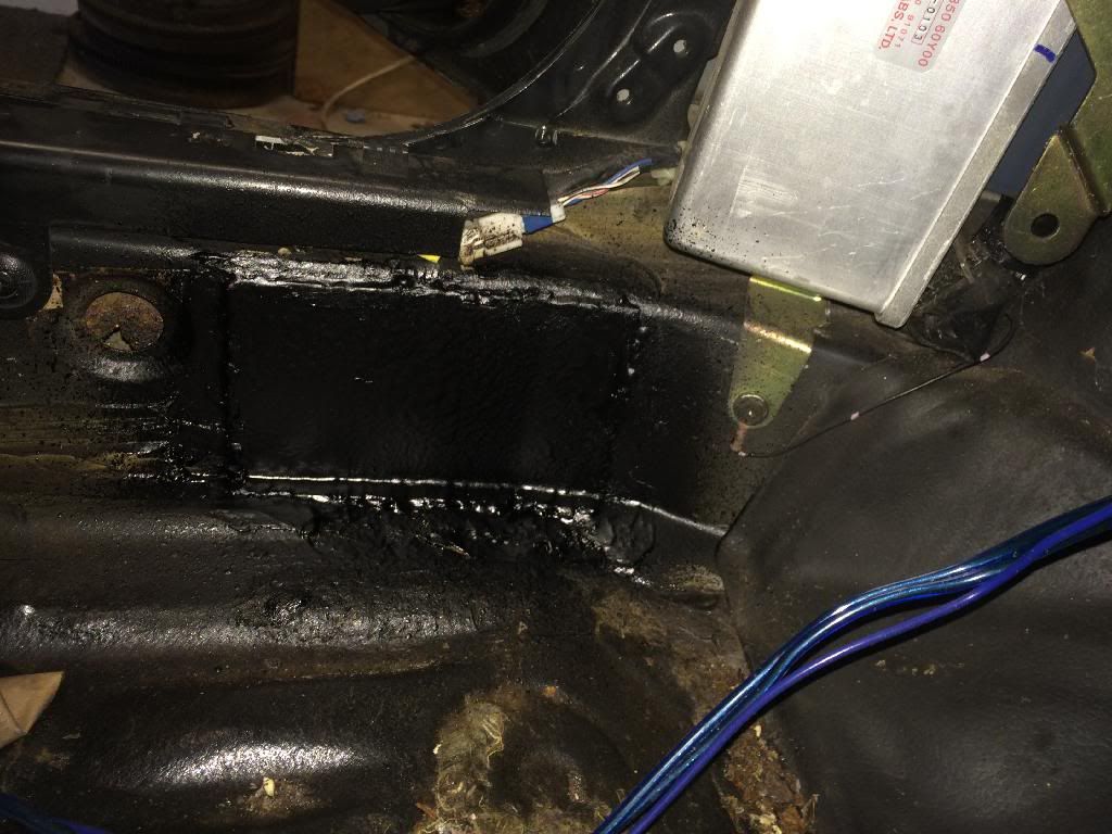

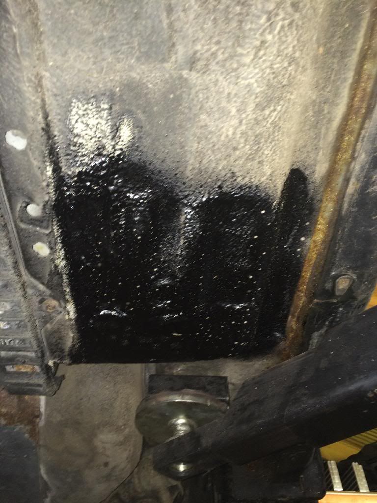

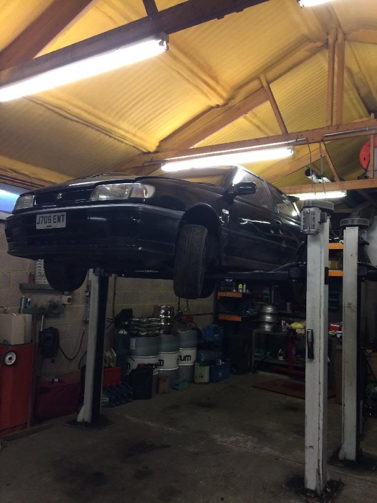

time now to chuck her on the ramp for a good poke around.... Suspension is ok no play that's all good the brakes are shot but that's ok one of the rear calipers has failed and is leaking from the piston, few exhaust rubbers need replacing to. all looking good so far.... Out comes the mot inspection hammer.... Damn hole in the rear floor about 3" or so.. On to the front and those sills look a little hmm wrecked some ones been here with a cheap trolley jack me thinks! And low and be hold..... Yep stick a couple of holes in both sills and worst I think I'll be doing the inner sills too..
my first pulsar might as well go for all the forums... 9E43F58F-D803-45EE-9434-DC73CDA43DCE_zps4g2rolb9
my first pulsar might as well go for all the forums... 075BC735-69AC-421B-BBAC-02F2FD19CF6E_zpsrcltbpts

So just a small update done some prep work for the repairs and it's not all that bad!
Just at the near side inner sill needs a patch but mostly good metal.. So when the new year hits.. My body shop boys will have some work to get on with Smile here's a few shots of what I done today it gives me a better idea of what needed to be done.

Welcome aboard to the site ..... seems like you have bought it back from the dead ..... bob (gtirus ) is the co-owner of this site strangely enough .... drop me a pm and il send you some pictures of a uprated clutch fork ..... as for advice on clutch ... mainly either drop the whole lot engine/gearbox/tranfer box out in one then seperate the gearbox off change the clutch or leave the engine in situ ... remove the tranfer box then its just the same as doing a fwd car ....i see you have acess to a lift so that makes life a little easier ... just becareful of the sump not to dent it wichever method you try .
