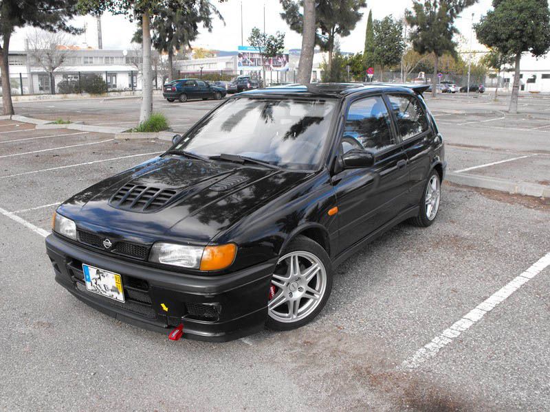

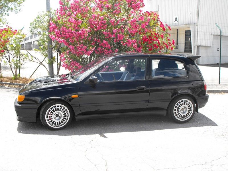

Hello guys, i´ve been around here for a while, but actually i don´t have a GTIR. it´s a turbocharged 2.0 FWD Sunny GTI
Quick Spec:
Stock unmodified EUDM 10:1 Sr20de
Td05h-16g Subaru STI turbo at 0.5bar
Tial EWG on stock adapted gtir manifold
Full 3" SS exhaust including Downpipe
GTIR fuel pump, GTIR ECU, GTIR MAF
440cc Yellow subaru injectors
Apexi SAFC2+Innovate wideband
Japspeed FMIC
Custom Koni CSK´s coilovers+Poly bushes
Custom Subaru 4 pots, 300mm Tarox G88 discs+ 300zx TT MC
GTIR bodywork + Compomotive TH2 in 16
Custom reinforced Kevlar clutch+ clutchmasters PP
It resulted in 303.8BHP and 310nm   Not a GTI-R, but a FWD GTI-T  Smiley2 epic fast i assure you

Im intrested in these coilovers how these were done .... is the bottom half a stock shock  cut then welded to a threaded tube ?
9Not a GTI-R, but a FWD GTI-T  Empty Re: Not a GTI-R, but a FWD GTI-T on 20th January 2014, 3:48 pm
groundscraper
@Andy Sunny Gti wrote:Rolling road print says Portugal.
Nice car mate as said on the other forum.
Yep, a Sunny in sunny Portugal... but not much sun right now... ahahhahahah... in fact is raining alot... LOL
@nomad wrote:Im intrested in these coilovers how these were done .... is the bottom half a stock shock  cut then welded to a threaded tube ?
The Compomotives are 16"...
The coilovers were custom made by myself, as most of the car...
It´s stock GTI struts, welded ford capri/escort sleeves welded in, custom rate springs, and Koni yellows(sentra spec V)  on the inside...
In the US they call this CSK´s, custom shortened koni´s... in fact is not that hard, you just need to know what your doing...
Way better then taiwan crap and almost every coil there is for the N14/RNN14...
This coils with the poly bushes all around, including steering rack, and the caster correction, plus the wide track of the agressive offset makes this car to handle like a dream, i love it... so confident inspiring...
