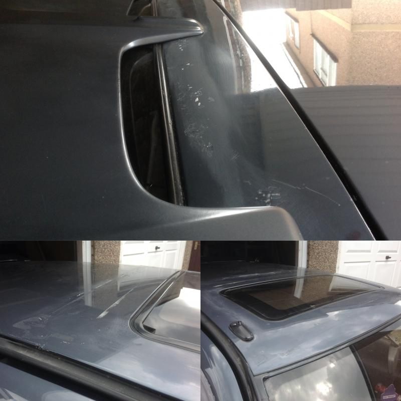

Hi guys/ girls..
What do you think is the best way I can sort out this paintwork?
Or is it either respray or wrap. Neutral
2 Re: Paintwork on 1st July 2014, 4:12 pm
Concrete-GTIR
that looks like its quite deep and the laquer has peeled a bit you could try a bit of very fine sanding ie 2000 grit then some rubbing compound then polish, waax, glaze see how it comes up Wink
3 Re: Paintwork on 1st July 2014, 6:39 pm
Indy
Yup as concrete gtir is saying it looks like laqure peel I wouldn't even bother wet sanding as you will cause further damage to the base coat a respray would be best
4 Re: Paintwork on 2nd July 2014, 5:50 am
Damm, was trying to avoid a respray but knew it would have soon been due.
