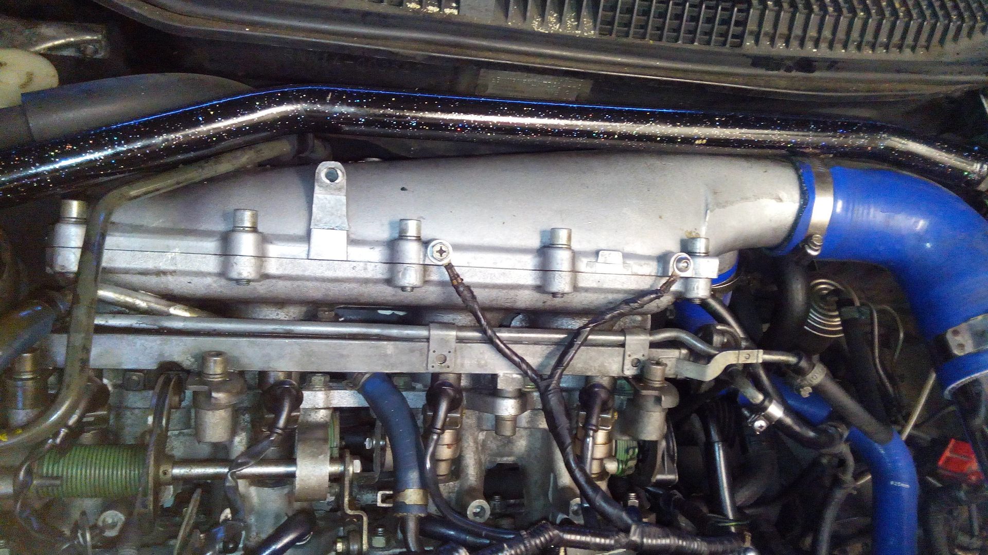

Hi y'all. Any one tried alloy wheel cleaner on corroded ally parts? I used one containing phosphoric acid on my plenum, fuel rail, dizzy & Maf. I used a tooth brush & kitchen paper & water to clean it off. It worked a treat." />" />

It kinda fizzes as the white oxide dissolves. I took my rocker dome nuts & washers off & did them look like new now!

Looks good - my plenum could defo do with a clean like that - where did you get the product from ?

That came up looking great, surprised how good it works thumbsup
