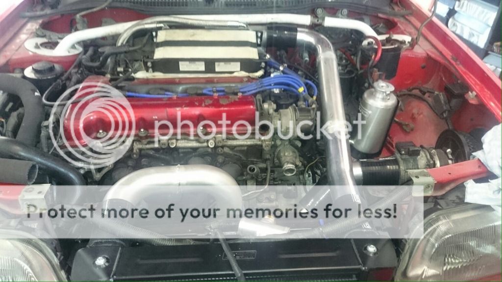

All the piping has been done now...a few pics might go up later;o)

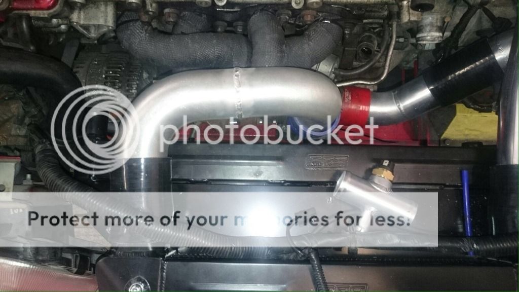

128Project...underway - Page 6 Empty Re: Project...underway on 14th October 2015, 5:05 pm
Project...underway - Page 6 IMG-20151013-WA0003

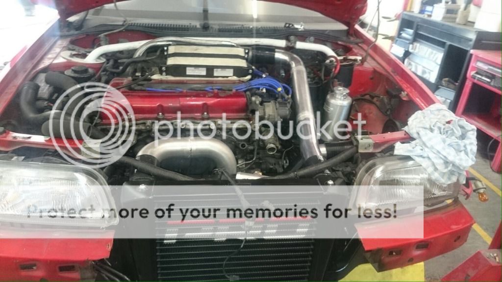

129Project...underway - Page 6 Empty Re: Project...underway on 14th October 2015, 5:06 pm
Project...underway - Page 6 IMG-20151014-WA0000

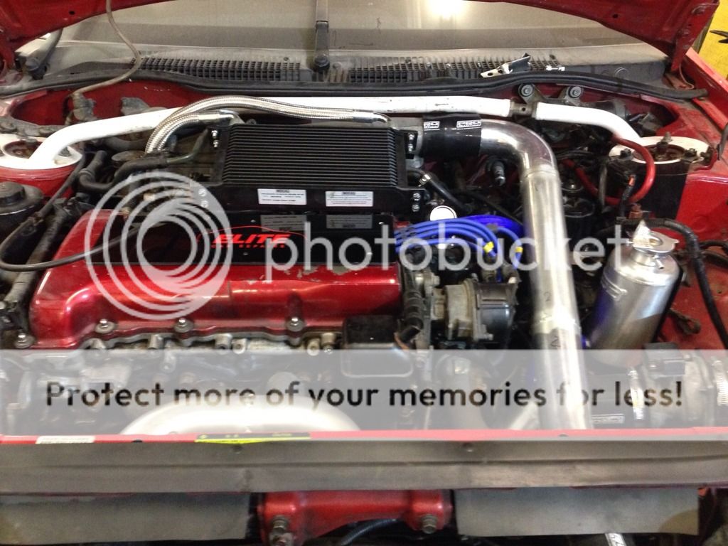

130Project...underway - Page 6 Empty Re: Project...underway on 14th October 2015, 5:07 pm
Project...underway - Page 6 IMG-20151014-WA0001

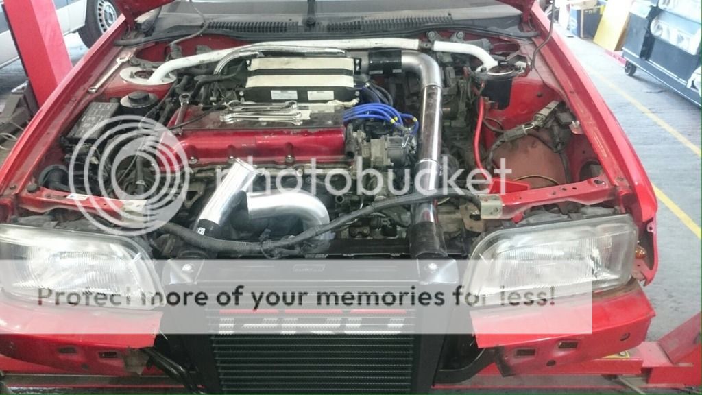

131Project...underway - Page 6 Empty Re: Project...underway on 14th October 2015, 5:07 pm
Project...underway - Page 6 IMG-20151014-WA0002

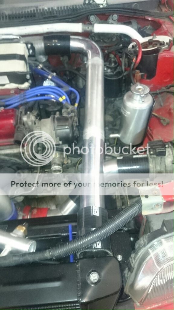

132Project...underway - Page 6 Empty Re: Project...underway on 14th October 2015, 5:08 pm
Project...underway - Page 6 IMG-20151014-WA0003

136Project...underway - Page 6 Empty Re: Project...underway on 14th October 2015, 5:43 pm
No problem sorry for the delay was working late .... looks good mate nice short pipe run should make a difference ....

Looks good mate. Is a really short pipe run and all fits quite nicely

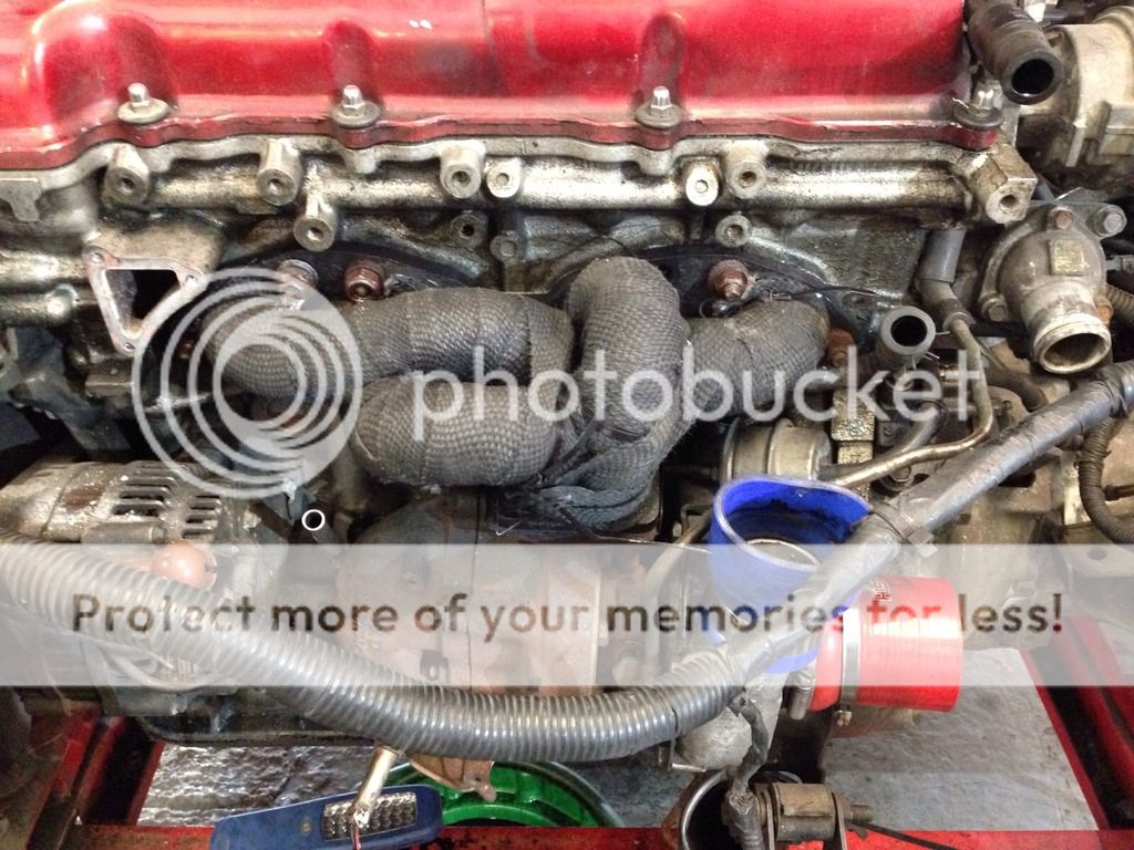

Looks good Daniel
only downside is that it has left you zero room if you ever wish to run a larger turbo as you would need to space the manifold from the block by means of spacer plate or wedge but neither would be able to fit in that gap
140Project...underway - Page 6 Empty Re: Project...underway on 14th October 2015, 9:45 pm
Looks great! what turbo is on it? it looks quite a big one already 2871 or 3071?

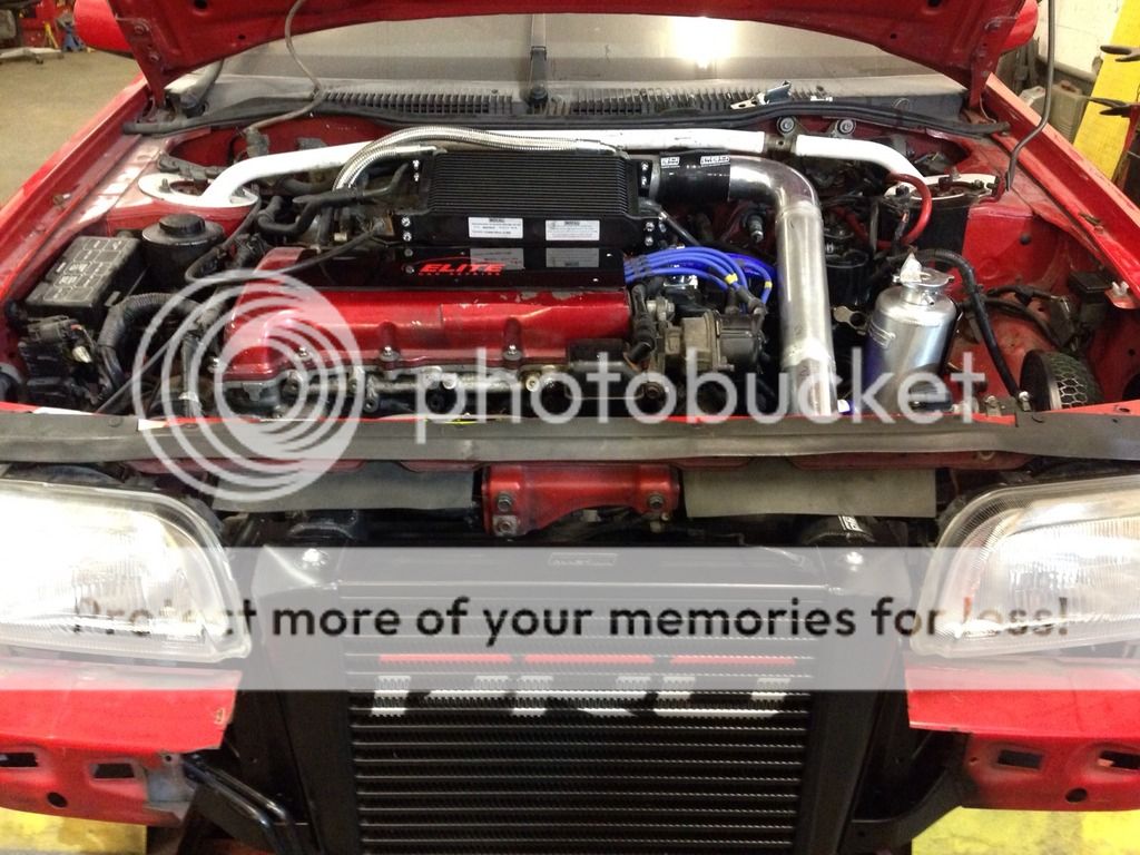

Project...underway - Page 6 IMG-20151014-WA0004
142Project...underway - Page 6 Empty Re: Project...underway on 14th October 2015, 10:34 pm
Project...underway - Page 6 IMG-20151014-WA0005

Think its a 2871 :O)

Tho....its not to say a mad custom manifold can not fit the turbo somewhere slightly madder Laughing

Good news is she is finished and started 1st time today...only bad news is we have found a small blow on the exhaust manifold....nothing major....will get it sorted when I can.
Changed the gasket....but the bolts are rotten....looks like the have been re drilled once before over the years....so planning block out to get them filled then re drill the holes and start fresh.

Looks so clean, love the engine bay pics mate Smile

why you taking the block out to re-drill manifold studs? seems rather drastic scratch
the turbo is a garrett 2871r

Well said Bob - looks like we have a more sensible way of doing it now lol

Do not for one min think I am putting you down at all it looks great set up and very well done a lot of time and money in this and great to see people puting time effort and money in. It's a genuine question as its someting that interests me. Small turbo big cooler to fill ?
150Project...underway - Page 6 Empty Re: Project...underway on 16th October 2015, 8:57 pm
Daniel232006
Good question...We spent a lot of time and effort doing the math...I can quell one myth now...intercooler size and capacity doesn't effect lag and boost like you expect.
On paper this was proven by the guys who built it....I've just got home from a shake down and the math seems sound...boost comes on at 3000rpm and I'm at peak boost by 4000-4500pm...the peak boost is slightly higher than before too at a bar and we haven't touched a thing in that department yet. The system works...I don't fully understand the science behind it and I wont pretend too - But proof in the pudding :O)
