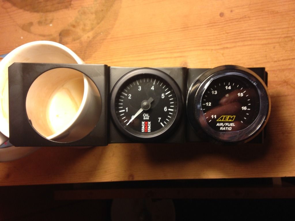

Just got home today and some of my goodies have arrived Smile.
Fascia panel to replace the standard gauge pod plus a mechanical oil gauge.
Here a pic of the gauge temp fitted along with my wideband, just waiting for the oil temp gauge to arrive which hopefully will be here tomorrow along with some clio 182 discs so I can fit the 2 pot brake upgrade. Should be a busy weekend hopefully I'm quite excited.
I have a question though. How do I fit the mechanical oil pressure gauge? The oil temp one I have brought a sump adapter so it'll go straight in there so would I tap into the hole left by the oil temp sender?

Thanks woody I think my oil pressure gauge is getting a bit tired now as I get different readings on different days so an upgrade was needed.
The manual says it comes with 1/8npt and a 1/4npt adapter. So if the thread is right I should be ok to plumb it into where the temp sender goes? I'd prefer to do it that way rather than remove the standard oil pressure sender so I keep the low oil pressure warning buzzer also so I can return it to factory if I need to.

Here's all the gauges in the pod. It's a shame they didn't design the pressure gauge more like the temp gauge as it would look more like the standard units.

@Supernova wrote:Here's all the gauges in the pod. It's a shame they didn't design the pressure gauge more like the temp gauge as it would look more like the standard units.
They do. The one on the left is a bogo stack gauge, the centre one is a pro gauge.

Oh! I wasn't aware of that that's strange because the one on the right was cheaper. Nevermind I can live with it.

Gauges look great. Shame about the difference but doesn't matter. A lot of gauges have a different sweep between electrical and mechanical though.

We have working gauges haven't plumbed in the wideband yet but the other 2 a re working.
Only thing is the oil pressure gauge is quite sticky, I tried bleeding the gauge a few time but once you turn the engine off some air comes back out of the gauge. It's annoying but i'm hoping it will settle once I drive it for a bit.
