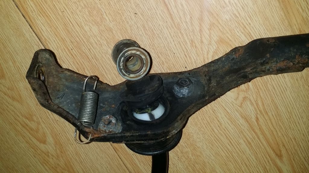

Just took the gear linkage apart Smile
Heres how it looks.
This bush looks dead.

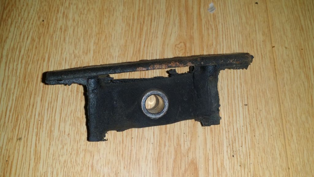

And this rubber bush that sits at the back of it all is split both sides. And doesnt have any resistance at all. Its very sloppy.
And the ball and socket has movement also. You can pullet up and down about 1mm each way. Its not a tight fit.
The spring is fine tho.
That poly bush above. Is that what replaces my worn bush on this arm. In my first 2 pictures?
28 Re: selecting gears on 21st September 2015, 7:48 pm
Yeh that bush fits in gear support rod front mount (bush is about £5)
The rear that goes into that rubber mount can be changed into a solid mount by replacing the rubber block with bit of box section welded in & drilled for bolt direct or oversized & a poly bush lathed down to fit.
Shimming or replacing the ball could be good too .
link below with similar info .
http://www.gtir-motorsport-club.com/t3088p15-linkage-bushes#63634

I made a solid mount from old rubber mount & used a bit of tubing & steel plate then found a poly bush slightly bigger than tubing & lathed it down, works well & even solid mount works ok & can buy them (in USA find them easily).

I will make a solid bush for the rear with box section as you mentioned Smile

Made the solid rear bush. It isnt pretty but will do the job just fine. I hope lol
46 Re: selecting gears on 24th September 2015, 7:46 pm
Nice one stu doesnt look bad at all ... got away without welding it then .... did you just drill out the middle for the bar to go through ...
47 Re: selecting gears on 24th September 2015, 7:52 pm
Thanks Leighton Smile
Yeah i bolted it to the bracket. It has raised the bracket away from the bottom of the car with the bolt heads. But i have compensated for that with the hole for the counter weight.
The counter weight doesnt have a purpose now but i have made sure it sits in the original location Smile
48 Re: selecting gears on 24th September 2015, 7:53 pm
And yes i just drilled out the hole in the box section for it to go through Smile

It serves a purpose and doesnt look shite so top job mr stu thumbsup fingers crossed thats your problem with selecting gears ....
50 Re: selecting gears on 24th September 2015, 8:04 pm
Thankyou Smile
Im hoping this and the new bush sorts it out mate.
My gears were back to normal when i took this apart. So i would of thought it was this at fault Smile
