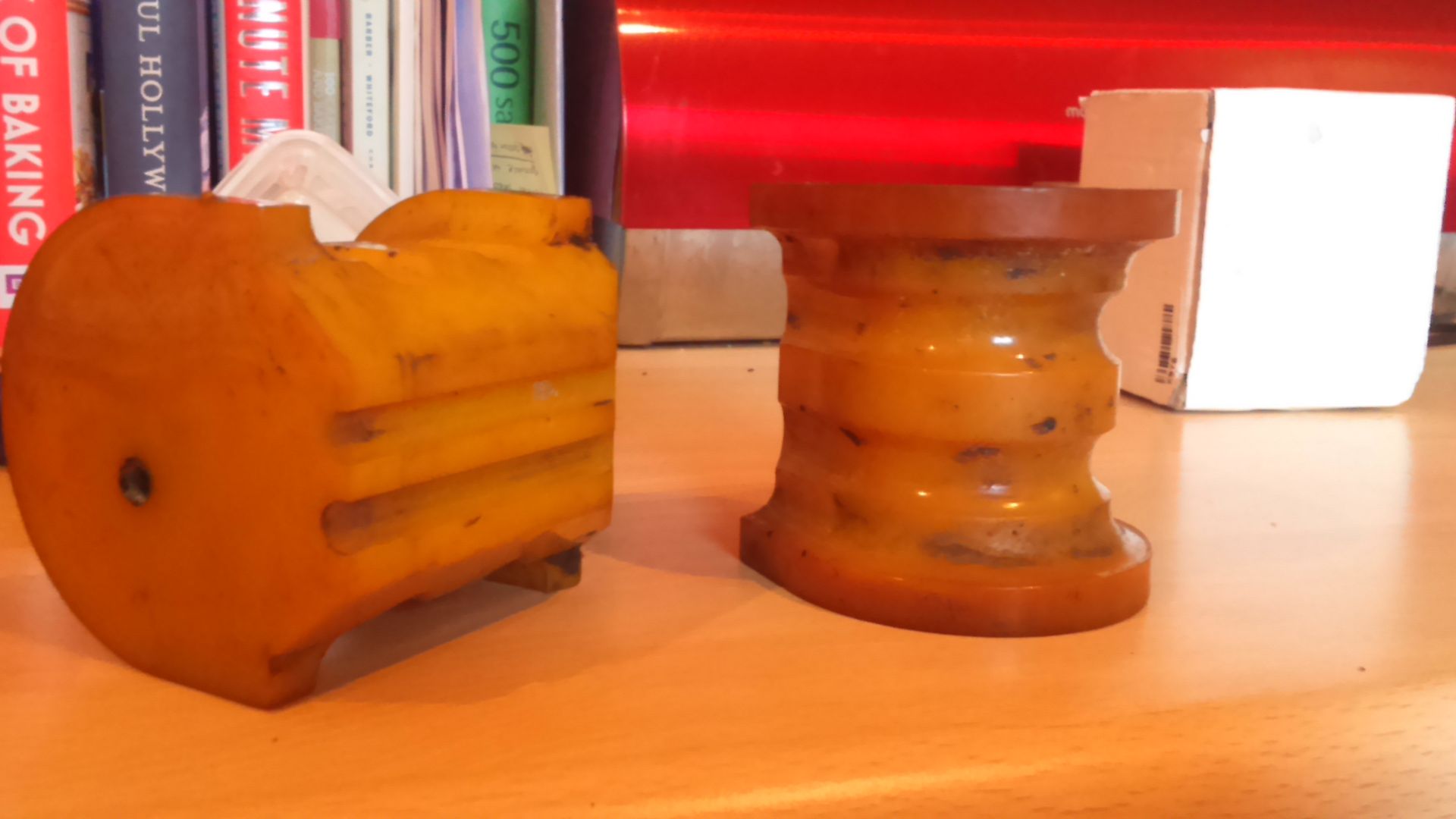

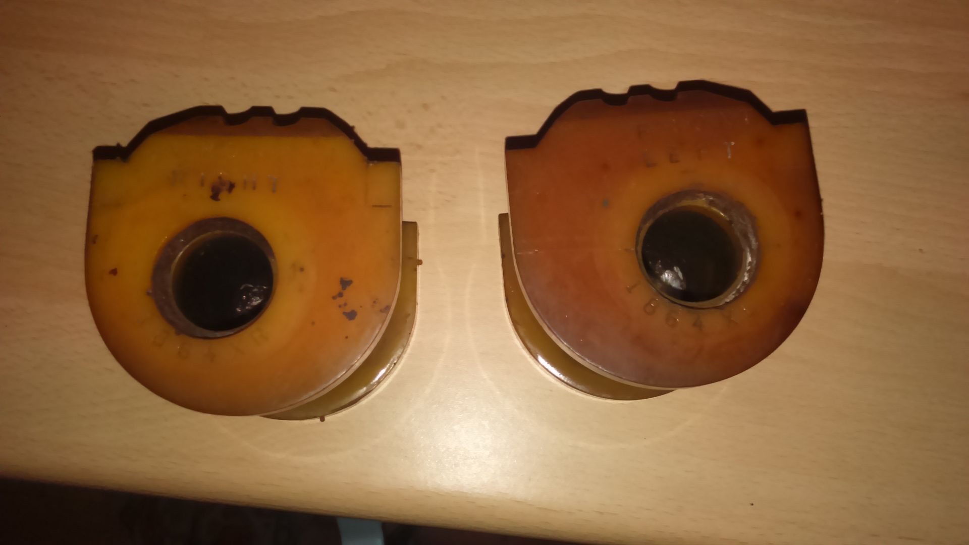

I've managed to get hold of some bushes which looks like whiteline anti lift kit
what I haven't got though is fitting kit (spacers and sleeves/washers)
All that crap which is not bush lol so I was wondering if anyone got rough idea how thick are those spacers and sleeves and do I need proper sleeves or can i just stick washer between arm and bush (or can i put there nothing at all)
Thanks Mike

That would be awesome while you at it can you just look if on your you've got any numbers mine got 1864xr and 1864xl
Thanks a lot mate

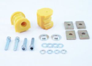

KCA346 kit contains the following hardware parts;#4 * M12 x 1.25 x 50mm cap screws#4 * M12 x 24mm washers#4 * M12 x 2.5 spring washers#2 * yellow polyurethane offset bushes#4 * alloy spacer blocks

It's not a proper sleeve (on there website they calling it sleeve) basicly  it looks like washer with 5mm collar and bush has got like 5mm recess to locate it
https://www.aftermarketsuspensionparts.com/prodimages/whiteline/kca346/whiteline-kca346-large-1.jpg
I'm about those ones between square spacers and bolts

@nomad wrote:KCA346 kit contains the following hardware parts;#4 * M12 x 1.25 x 50mm cap screws#4 * M12 x 24mm washers#4 * M12 x 2.5 spring washers#2 * yellow polyurethane offset bushes#4 * alloy spacer blocks
I'm just looking at this list and i think I've seen somewhere sleeves listed too but to me it only looks like something to prevent arm from rubbing directly on bush...

they're slightly sleeved washers if you know what I mean, seem to be there just to stop the shit getting in to bush as that pushes on to wishbone and is fairly snug fit.
instructions on fitting are here.
http://www.whiteline.com.au/docs/install_guides/Z237_Z5101.pdf

Sorry dude, the spacers are 30 x 50mm and 8mm thick roughly. Best I could do as there fitted. Paul
22 Re: Whiteline anti lift kit?? on 4th October 2015, 4:02 pm
The washers I couldn't see easily but when you get your wishbone of and remove old bushes, the washers go on first and are a Jimmy saville fit (interference) so measure your wishbone for exact size and you should be OK.
