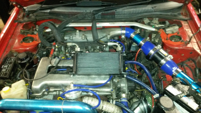

Well its been a busy day again in the garage again today, Engine is now in (feeling pleased) how ever it wont run.. Bare with me and ill give you my low down and it should save a billion questions.. Smile
So firstly here is the current finished all be it un tidy fitted beast... I am very open to comments and suggestions but it is a working progress so go easy Smile I know the oil cooler pipes are going to get trapped if I close the bonnet I did move them first Smile
As I said I would this is my new toy :)  - Page 2 20160210
So Starting issue... First off I found the gearbox plug issue that I had seen somewhere on here... Sorted that and checked fuses, found a 10 amp one out.. unsure if it was related but changed it anyway.
Then opened up the idle valve a bit more as it tried to fire but just wouldn't go... Had no joy, had a coffee and a think.. The though hang on are all the pipes correct?
Found this one off..

I openly admit ive probably bitten off more than I can chew by this point but ive got to learn some how..
I also found a pipe right under the throttle sensor that was off and hanging loose.. not sure where that goes and its really bloody hard to get a pic... Im wondering did it go to the pipe in the first pic that heads off somewhere round the back of the manifold..

Im guessing that this means its all to pot lol
If your free and not busy bud yes please as ive tried all sorts on top of whats been listed...
I thought I may have flooded It so disconnected injectors and took plugs out turned it over several times and made sh1t bit of difference, it was running when it cam out and im almost certain its the dam little pipes ive got wrong Smile
cant fix it

So now im home and have my laptop here in front of me... I think I have found a good part of my issue... the boost solenoid is defo going to the wrong place and possibly the carbon canister isn't plumbed in correctly as well..
Checking the diagrams against my engine http://www.gtir-motorsport-club.com/t895-diagrams the pipe on top of the wastegate I think is wrong.. it should connect to the boost solenoid the boost solenoid is also connected wrong as it should go to one of the vac pipes under/back of the plenum. Currently its not.
Sorry for the ramble im trying to figure it out, if im on the wrong track then stop me.
thinking back to the drawing board tomorrow after work this time with diagrams in hand.

So it turns over fine just doesnt fire .... have you checked for fuel and spark .... i know obviously you have vac issues also ....
