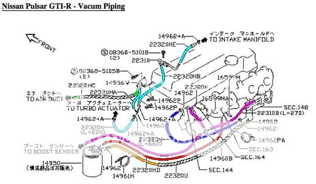

So the pink hose in the picture above. Goes to the fpr and boost sensor?
The blue one goes to the bov?
I have removed my bov at the moment as it was leaking..
Can I use the bov vacuum for my greddy boost gauge?
2 Re: vacuums on 12th March 2016, 5:46 pm
And the red hose in the picture. Is that the vacuum nipple by the tps on the throttle bodies / inlet manifold.

I thought I knew in my head but that photo seems to contradict scratch Im sure there is thread somewhere

I confirmed it with this one.
I just need to know if I can use the bov vacuum for my boost gauge or do I T into the fpr vacuum?
Can I take the vacuum off the factory boost sensor now I'm not using the standard boost gauge?
6 Re: vacuums on 12th March 2016, 10:35 pm
Go off the standard boost sensor I personally keep the fpr one by itself mate

I just t pieced into my boost sensor for boost gauge ....
10 Re: vacuums on 13th March 2016, 2:57 am
@Stu wrote:Do i still need to keep a vacuum feed going to the boost sensor?
Standard boost sensor is only used for the centre gauge im pretty sure mate, so up to you whether you still want to use it.
