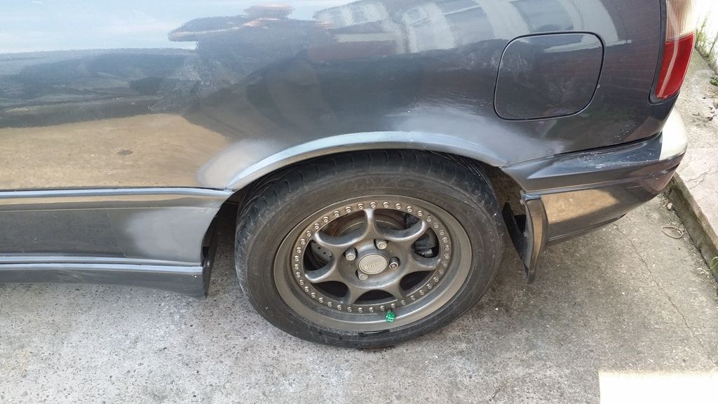

My rear arches were starting to bubble.
So i sanded them back. Treated them. Filled them. Primered them and painted and laquered them Smile
I still need to wet n dry them and then g3 paste them.
Looks a lot better than the bubbling paint Smile
my rear arches.. 20160512_201731_zpsmq0xijgk
my rear arches.. 20160608_174703_zpsvpycjbxy
my rear arches.. 20160513_124159_zpswr0338ac
my rear arches.. 20160608_174713_zpsqelowums
Looks more tidy for the summer shows Smile
Will do until i can afford to put the car in a bodyshop..

Thanks guys.
I did one arch in a morning and then did the other arch the next morning. It wasnt to bad as was only surface rust in most places.
Then left it a week or so and ordered the paint and laquer.
It isnt perfect. But is 100% better Smile

I'm guessing you just re-painted a small section stu? I wish I didn't use the can on whole quarter when I did mine.
13my rear arches.. Empty Re: my rear arches.. on 8th June 2016, 9:25 pm
@Ricks1983 wrote:Dammit! Haha I'm on the hunt for some then by the looks of it
There was some on ebay. Search enkei.
@gtir_woody wrote:I'm guessing you just re-painted a small section stu? I wish I didn't use the can on whole quarter when I did mine.
Yeah just the patches you see with primer mate. I went around the arch and didnt mask it either. So no line to try and delete lol
I will wet n dry the whole panel and then g3 it. Hopefully it will blend in enough Smile

I wet flat the arches today and the laquer line shows Sad
So i have decided to sand it back to the primer and just 2pk paint it as it doesnt need laquer so should blend in better.
Bit of a set back but hey you learn something new every day lol

Maybe dont wet and dry it Stu just polish it? G3 and then some g10 may smooth it out enough?
21my rear arches.. Empty Re: my rear arches.. on 9th June 2016, 7:07 pm
mc_hawkings24
You need to paint up to a swage line or do the whole panel to hide laquer lines. Use feather edge foam to go up to swage line which gives a better finish. You could light scotch right up to the bottom of the window then spray base colour to swage line then laquer up to the window to hide everything.
22my rear arches.. Empty Re: my rear arches.. on 9th June 2016, 7:25 pm
Thanks for the info. I was thinking of painting it upto that line so will probs do that.

So this happened today Smile
my rear arches.. 20160610_120052_zpseepysykq
I painted upto the swage line and then realise i would have to laquer the whole quarter panel anyway so keyed the rest of the panel and painted it all Smile
I have done both rear quarters Smile
