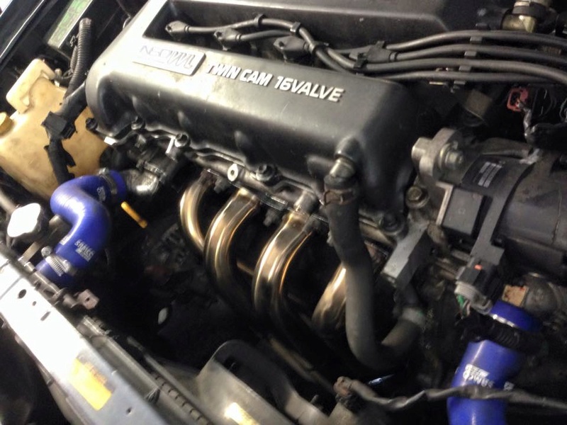

SR20VE engine from states
Hks f con pro gold management
Jap import Nissan pulsar 1.8 Gti lsd gearbox with uk sunny Gti gears
200 sx injectors
Cusco front and rear braces
D2 coilovers
Tarox 10 pot front brake kit
Team dynamics wheels
Custom tri y header

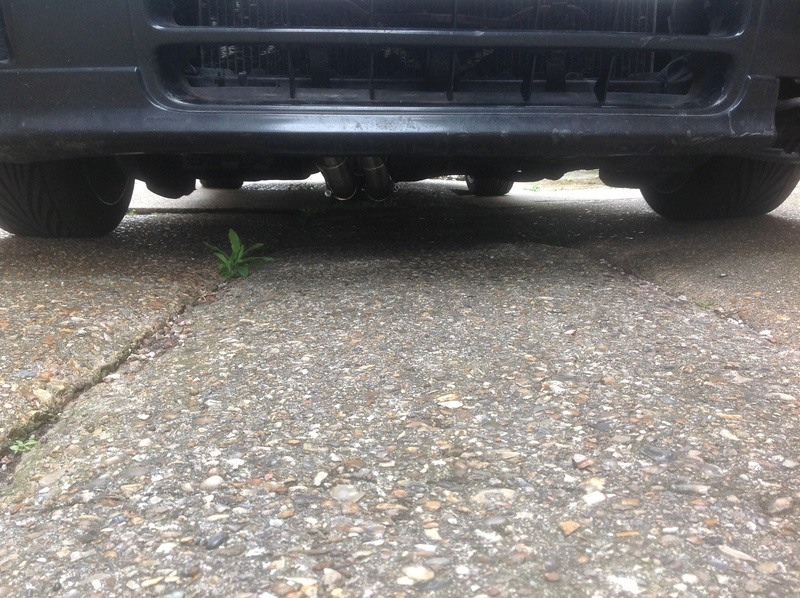

Custom 3 inch flex and exhaust system

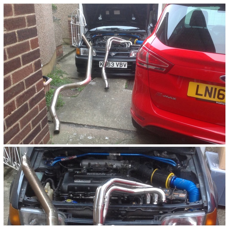

He is on the shelf with me using a 3' exhaust system, he said it might loose power.
I just told him, I've heard good and bad about using 3' on a n/a motor, so let's see.
I would have thought 3 would be ok mate, just another thing where people have mixed opinions and experienced different things on their motors.
So much will depend on cam spec and header design, gas velocity is very important .
Well worth trying and only way know for sure is try it on rollers, 2.75 is probably safer bet but never try never know .
Ideal concept is secondary pipe run switched at higher rpm so get benefit of more torque from high velocity gas/scavenging and less back pressure once in high rpm .

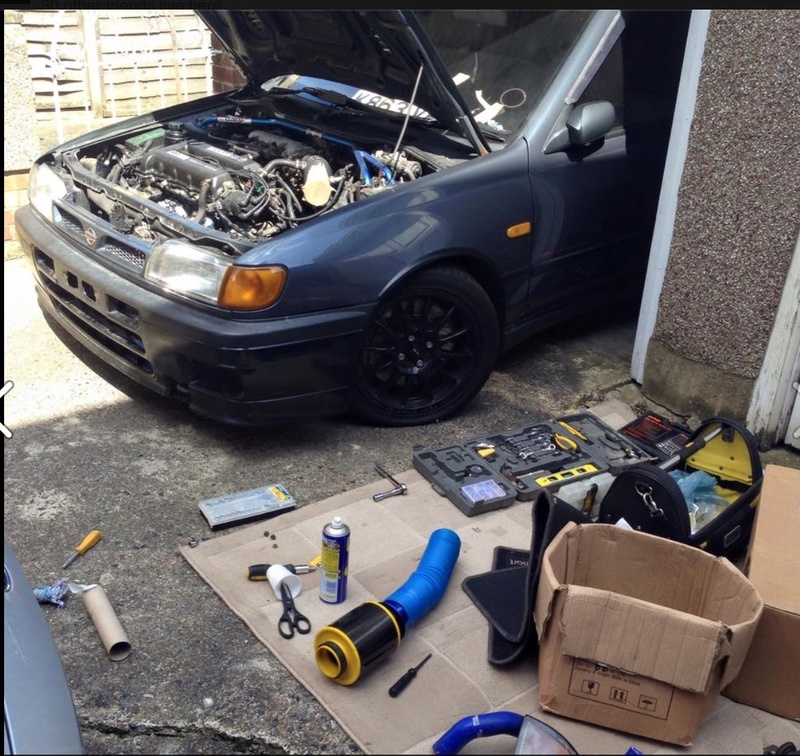

New Windscreen done
New Clutch going in, my flywheel is being skimmed as it was scored quite a bit due to the slipping clutch in before
New dowels for the lightweight flywheel being ordered
Then Mot and fine tune on the rollers.
Once complete will be giving the car a full re spray or getting it wrapped.
Watch this space guys...
