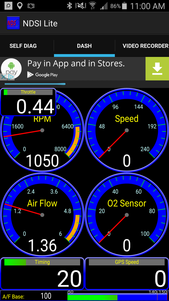

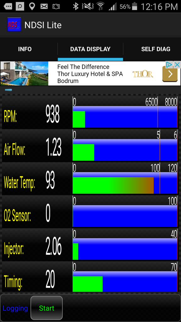

Heres the readings from the data scan.
I'm stumped! Screenshot_2016-08-12-12-16-34_zpsdhtphazb
I'm stumped! Screenshot_2016-08-12-11-00-23_zpszhfexy7c

02 sensor reading was all over the place when the issue was happening so I disconnected it but it didn't make any difference.
