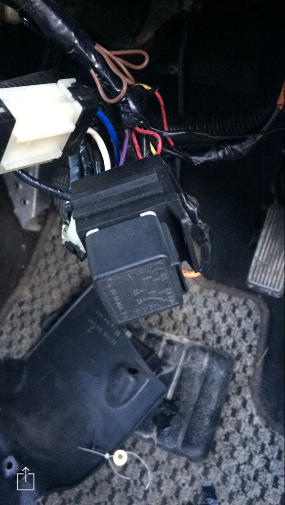

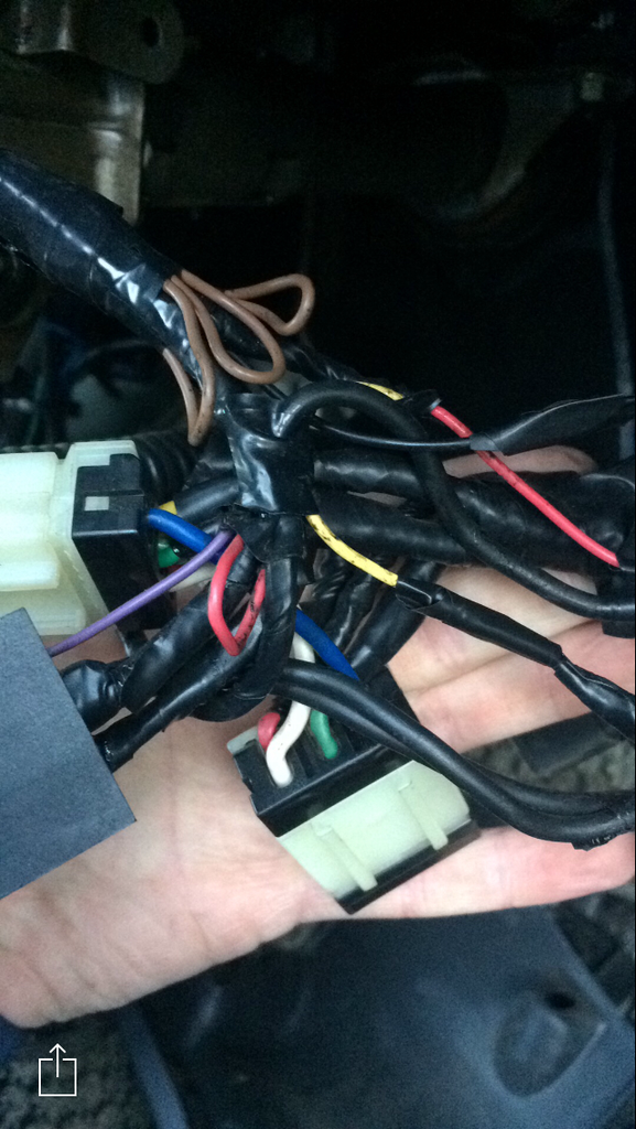

So I was going to fit a better alarm to the car today until I looked under the dash. A maze or spliced wires, and hooked up relays. Just stripped wires wrapped around other stripped wires and insulation tape holding everything together.
Removing aftermarket Controllers 4A7100CD-6CEE-4C14-A310-46B71BF6DB80_zpsreqbwj8m
Removing aftermarket Controllers D3AB5262-1637-43C2-ACFB-B9D7247F6CD1_zpsd7ct6k7c
There is a boost controller no make and I don't know what setting are on it cos I don't know how to use it.
Then there is a "Gizmo Fuel Cam" controller: From what I see you can control air/fuel and cam settings.
The previous owner said these were set up to run with the sard ECU. But I am guessing these are not very accurate settings. Not like a remap or anything so how good can they be? Would the SARD ecu on its own not be just as good?
I don't want any of them really, and would prefer to get the wiring loom nice and neat again not a maze of random spliced wires.
If i were to just remove them and do nothing else would the car run ok do ye think? Or would I be better off just leaving them in it and work around all the wiring.

We're these other gizmos adjusted to suit the map while it was on a dyno.
Or did the last owner just install them and put them at the settings that the install instructions say to.
If the latter I would say it's okay to remove them and clean up the loom.
I'm no tuner or qualified mechanic tho so this is only my thoughts on it.
Cant see them being setup on a dyno if they are just twist and tape installs lol
What boost are you going to be running?
The cars can be run on upto 1.3bar of boost without any afr mods.
What spec are you intending to keep and add to the car in the near future?

Put a couple of pics of the controllers up. I would not remove (unless there only monitoring) them if they alter anything without getting the car on a dyno straight after. I am no expert but I have seen how minor changes make a big difference to the map even air filters etc

I am lost off ? you said it has a maze of wires and a controller to adjust the air/fuel so that will be wired in ? That will be running along side the Sard Ecu to tweek the settings more so will of been adjusted on dyno so if you disconnect them the SARD Ecu unless the cars set up again won't be ok just to drive about in my opinion
8Removing aftermarket Controllers Empty Re: Removing aftermarket Controllers on 28th January 2017, 9:39 pm
Wouldn't removing the wired in afr gizmo just put it back to standard?
If it's like the hks afr it's inline on the afr wire so wouldnt affect the sard map because it wouldn't have been mapped into a generic map.
Thats how I understand it anyways.
Sounds like it's just a basic afr adjustment.

The daughter board changes the parameters and then the controllers further alter them so removing one or the other the car would need set up. Unless the lot is removed and you run standard boost. Anything above requires afr gauge minimum and over a bar I would be putting it on the rollers for a accurate set up as age of parts and every engine differs

Yes the controllers are inline after the ECU, so that is the way it is working at the moment. The only thing I am trying to consider is did somebody who actually knows what they are doing do this or was it just some random person who thinks he knows what he is up to, and by the looks of the wiring it seems like a home DIY job.
I know the correct thing would be bin them and just get a proper map put on the car, I plan on nistune at some stage in the future. But at the moment don't have the cash for that. Might just hook in an AFR meter and run it on the SARD ecu on its own see how it goes.
12Removing aftermarket Controllers Empty Re: Removing aftermarket Controllers on 29th January 2017, 5:15 pm
Without seeing it or afr could not tell you but they must be set fairly accurate or it would not take long to kill the engine and if they were not set right it would run shit. Not all tuners are good with wires and maybe he wired them in and they work so were set up at last map.

That's the problem with buying these cars I suppose. It is the first car I have bought that has been messed with and not fairly standard. I have always searched for a car that has not been messed wit too much, a blank canvas so to speak and build it my way from there. I just have a seriuos lack of trust with the quality of mods by previous owners.
It runs well as it is so I suppose you do make a good point. why change it if it is running well. The SARD ecu on its own is still an unknown.  I could hide the controllers behind the dash and try forget about the spiderweb wiring.

Have you pulled the tape off and see if its been soldered on .... i would just tidy them up and keep controllers where you can access them if needed ... get a wideband that will give you abit of insight on hows it running .... if it runs good and your happy with the power then leave it .... if it aint broke dont fix it kind of thing ...

I have indeed and that's why i want to pull them off. Not a patch of solder in sight!! I could spend a day soldering wires to fix the work, and where the wires are routed is a disaster.

I'm probably the odd one out here, but I've had several R's and the first thing I always do is remove ALL aftermarket stuff, including alarms, bov, front mount etc and get it back to standard. Replace the ecu if it's not standard or had bits added and then at least you can be fairly sure the car will run. If the wiring is in the mess you say then I'd just get rid... Good luck.

I kind of with John on ripping it all out approach and more so when fitting a serious bodge, Ways yours done sounds bit of a amateur mess. Main thing is get fueling checked & general check of other parameters.
