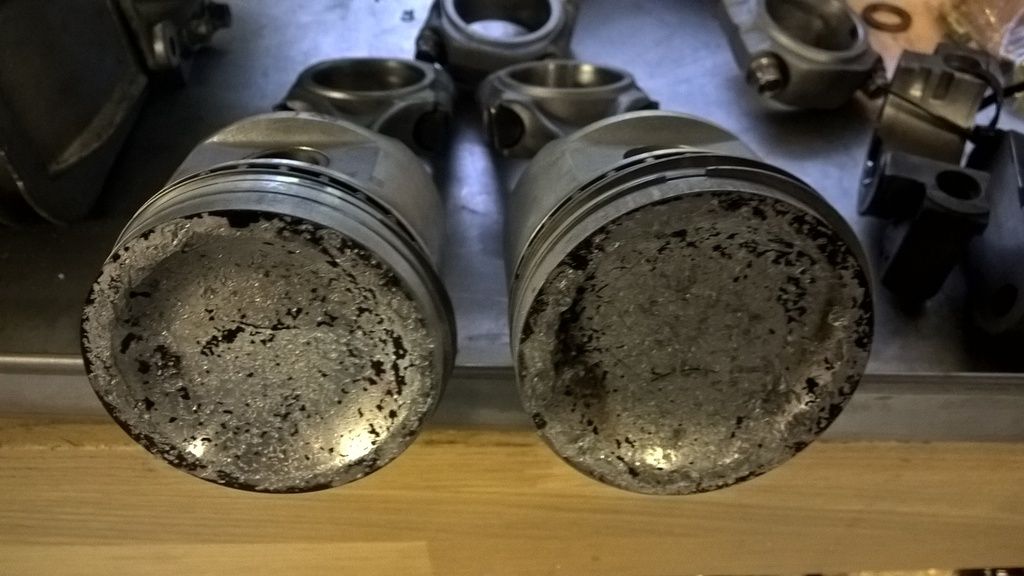

So after making a fatal error when fitting a new carb and running the engine with a washer in the inlet Embarassed it was time to take the engine apart for a rebuild!

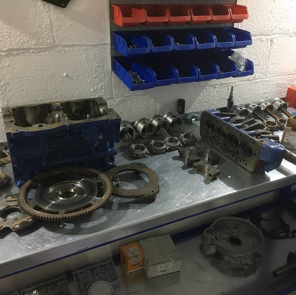

Striped to its component parts
Im no expert but these dont look right!!

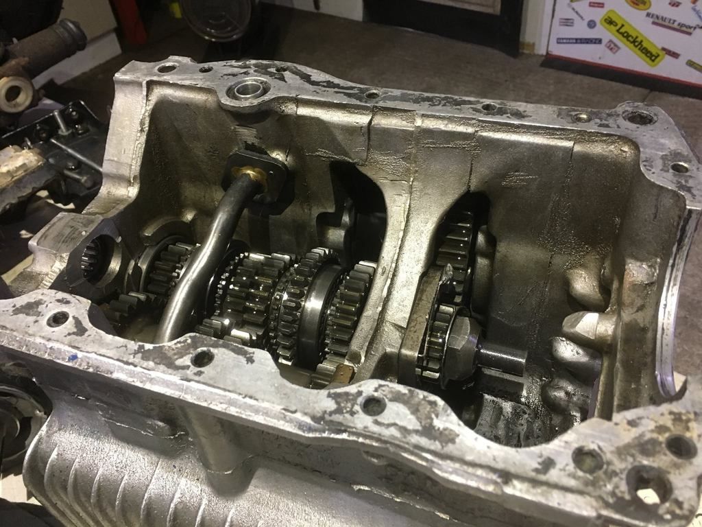

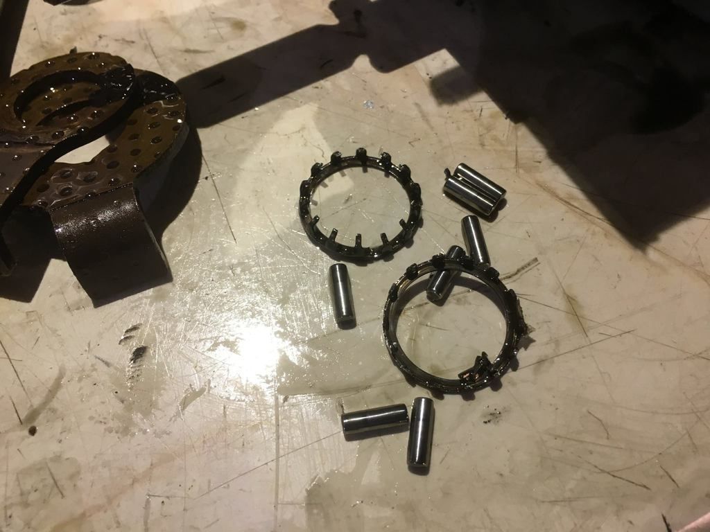

Checked the gearbox and found broken bits! (Bob did tell me there was something not right in there)...

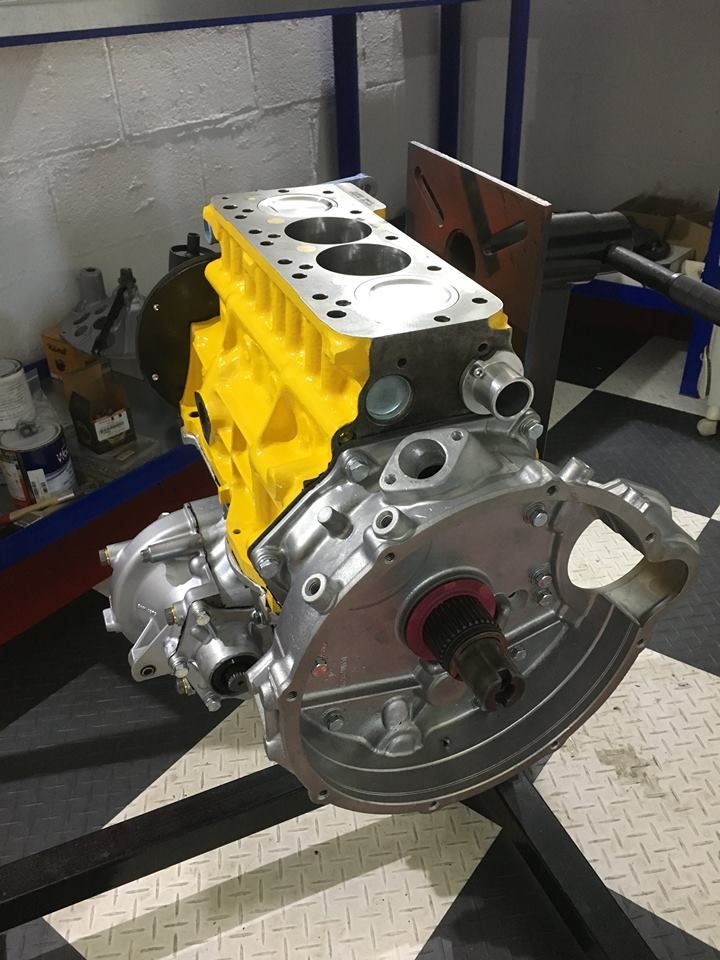

Then started putting it back together...fun bit!

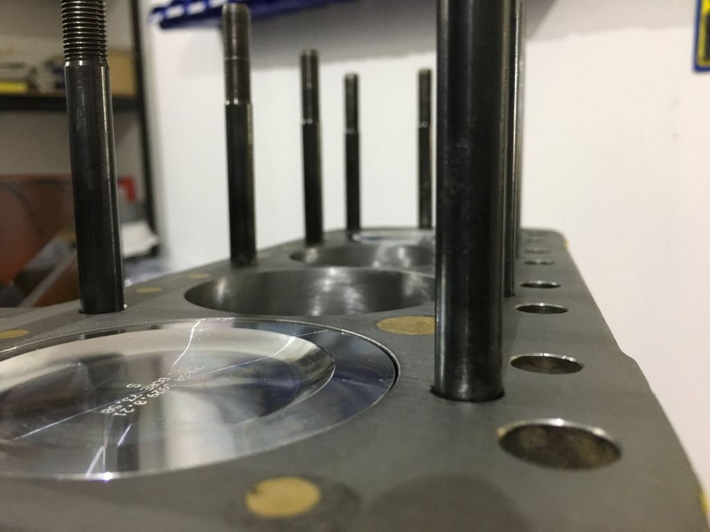

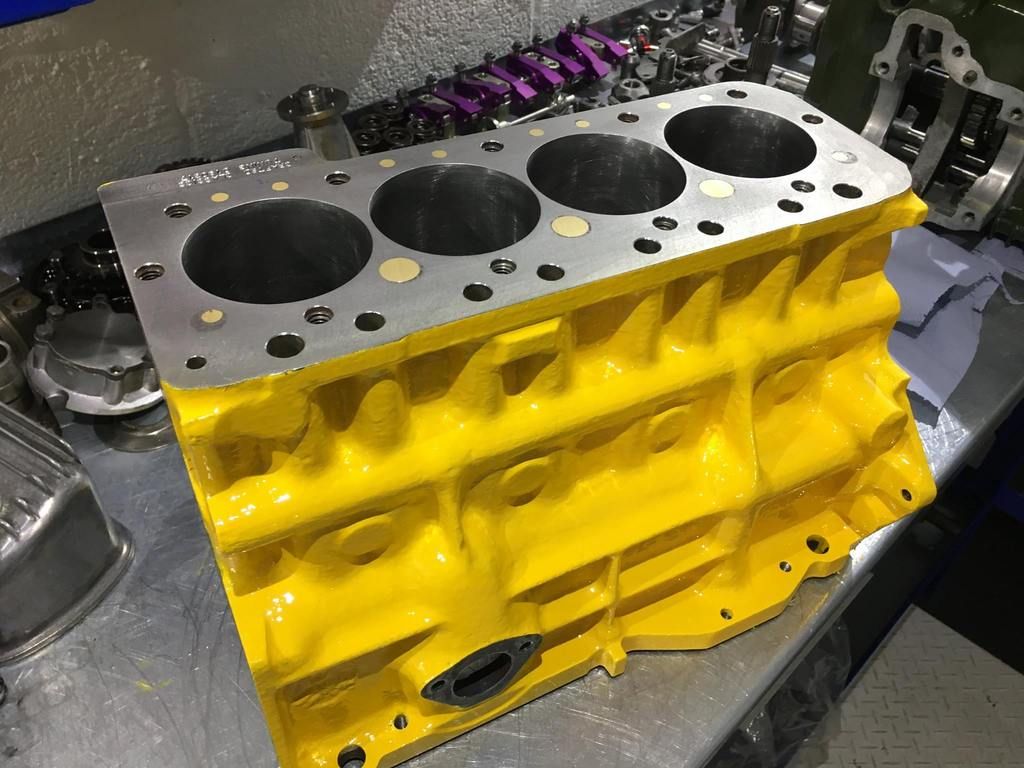

Block honed, skimmed and painted up. Also has been machined for a dry deck conversion.

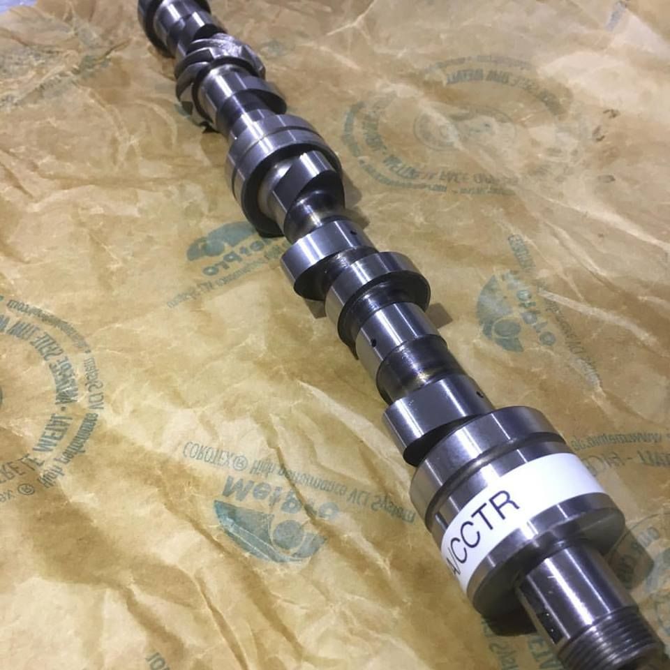

Custom made camshaft made...first one of its kind Twisted Evil

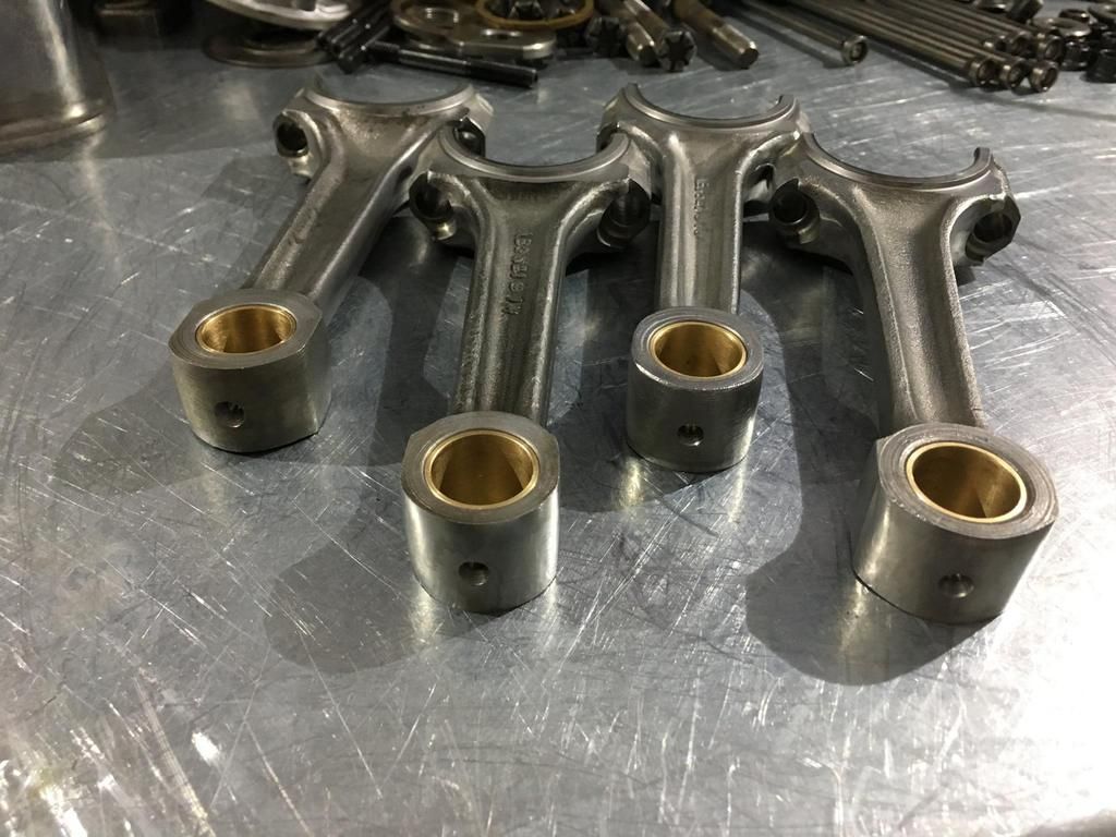

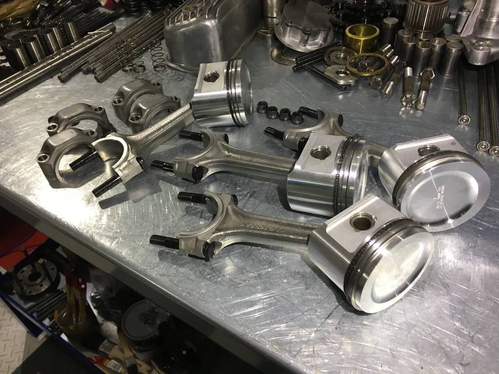

Rods
New forged pistons with floating pins
Arp studs

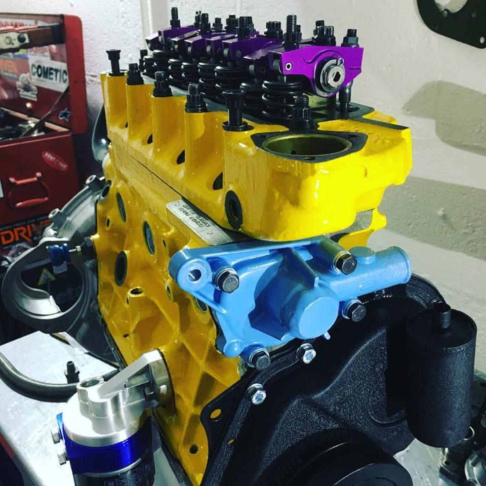

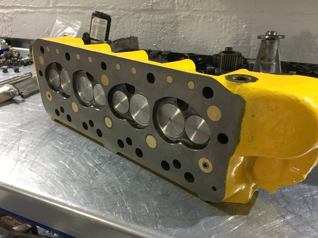

Head skimmed, valves machined down to the largest size that would fit in the head! Waterways plugged for dry deck conversion

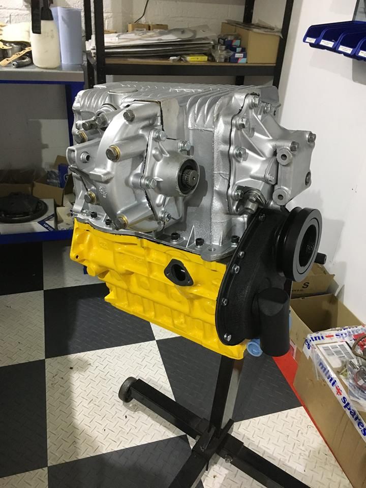

Block starting to go back together now

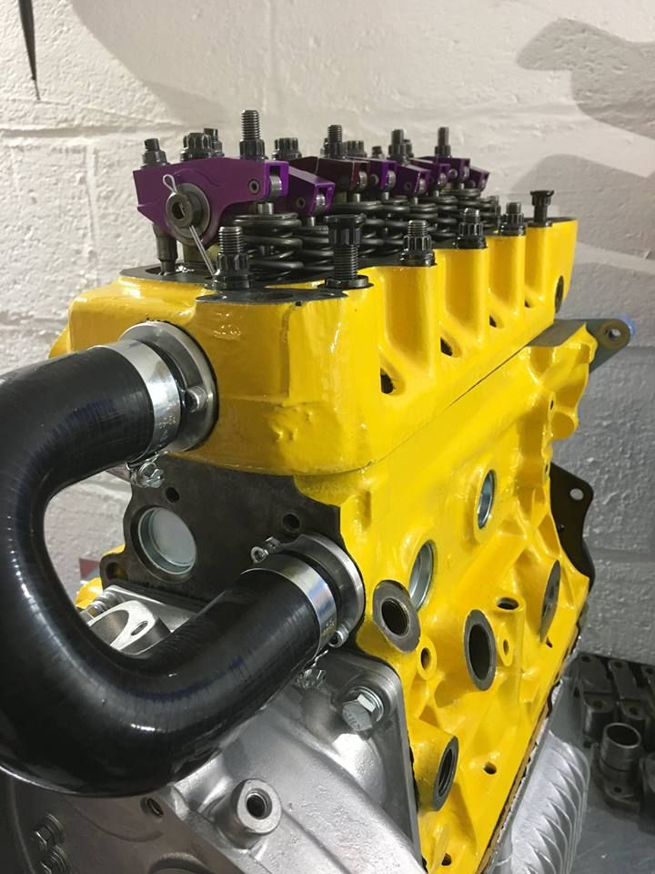

Starting to look good now!

Nice build mate. So what exactly is it you're building there, 1380, 1310cc? That cam looks interesting as well, scatter pattern or just 'wild'?  Smile

I've got a gearbox like that too, sounds f'kin mean when you wind it up  Very Happy

Its a 1430 lump should be good for around 150 horses.
Not sure about the cam myself. Someone far more knowledgable did that bit. Will be horrible until around 1800rpm but rev to 8500 / 9000!!
Yes, straight cut gears sound awesome....

My one's a 1330cc with a 286° cam. Same roller rockers as you too. The old engine was a Morspeed supercharged lump (spits on ground) with the straight cut box. You could literally hear it from a mile away  Twisted Evil
