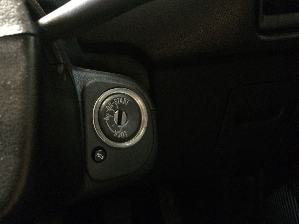

I think I have one in mine. This is what they look like.
Illuminated ignition ring 6B597E71-8996-40BB-896B-E8A3DD9BA899_zpsptxexcr1

How many wires is it? When does it light up? When you turn on the ignition or beforehand? If it lights up when you turn on the ignition just put the positive to a remote turn on such as the cig lighter or the remote turn on wire for the stereo.
I have never turned my car on since i bought it so don't know when it lights up
If it lights when you enter the car you can wire it to the dome light or direct to the trigger on the door so when you open the door the switch turns it on.
15Illuminated ignition ring Empty Re: Illuminated ignition ring on 2nd June 2017, 10:37 am
The one that was in my old R was connected to the interior light circuit. Only reason I know this is that the switch on the door wasn't switching off the circuit properly and the illuminated ring was draining the battery slightly overnight. There might be a spare plug for it under the steering column shrouds if you're lucky. Failing that you'll have to trace the wiring for the door open/interior light circuit somewhere and tee into it
