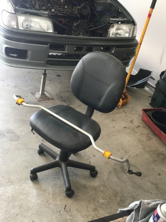

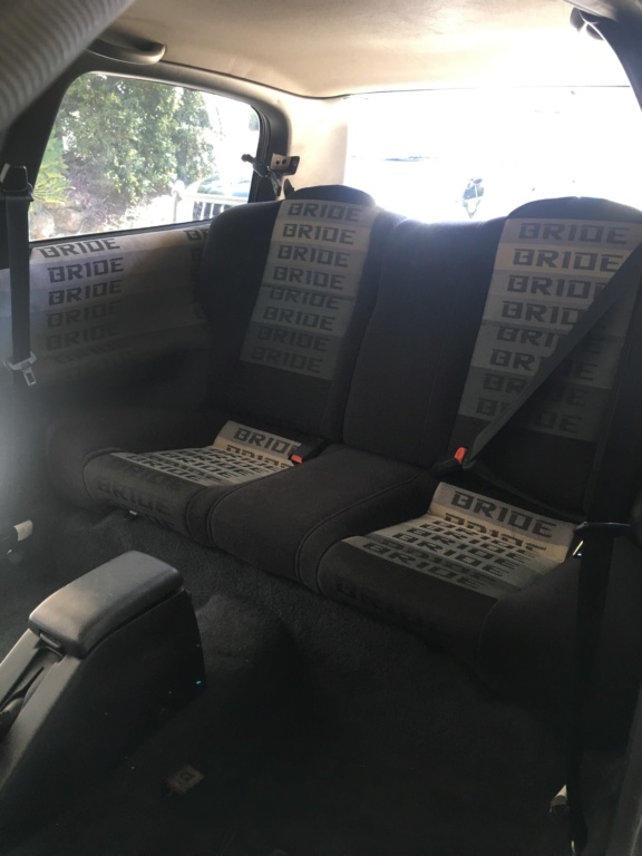

Spent the day building the back part of the interior and ran my live cable down the left side of the car, fitted mint under the plastic covers that runs the wiring to the rear. Breaker on order and small battery to be fitted in to the tool box area..
stereo mounted on its brackets, and black dials are coming for the main gauges as I don’t like the white ones..
rear brakes all cleaned and getting painted..
also got round to painting the black NISSAN” on the front calipers..
also cleaned up the rearsway sway bar and bushes come up a treat just need the whiteline sticker...????????
