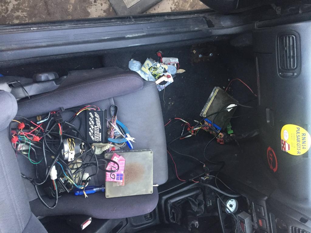

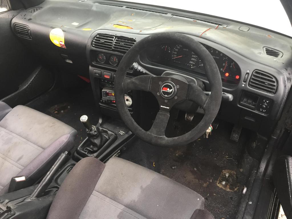

Now that it is a driver, I've been spending more time inside the car instead of under it. Time to clean up the interior!
I started by removing as much of the sticker, double sided tape, wire clips, etc from the dash. This meant getting all the way into the gauge cluster to get the yellow carbon look stickers off of there.
With the dash apart I was able to undo all of the electrical routing strung through the dash. I moved everything to the passengers side so it could be sorted all at once. The previous owner even cut and extended every heater control wire with red wire and bullet connectors so that it could be stored in the glovebox while all the add on bits were screwed to the dash.
Track Rat - '91 Pulsar  - Page 2 IMG-0422
Much better.
Track Rat - '91 Pulsar  - Page 2 IMG-0441
This left me with this impressive pile in the passengers area. Everything on the seat was deemed useless and removed.
Only kept the boost controller, digital water temp, and power meter were kept (won't ever use it elsewhere.)
Track Rat - '91 Pulsar  - Page 2 IMG-0477
This was my favorite wire Rolling Eyes
Track Rat - '91 Pulsar  - Page 2 IMG-0443
Lots of cutting, crimping, heat shrinking and it finally all got put back into it's proper place.

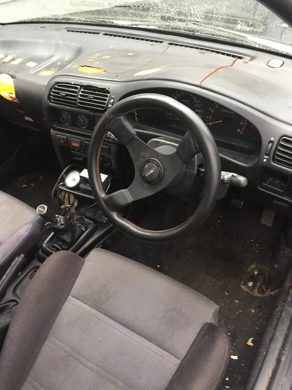

Track Rat - '91 Pulsar  - Page 2 IMG-0507
Tried on a steering wheel that I had around, liked it better.
Track Rat - '91 Pulsar  - Page 2 IMG-0484
Track Rat - '91 Pulsar  - Page 2 IMG-0505

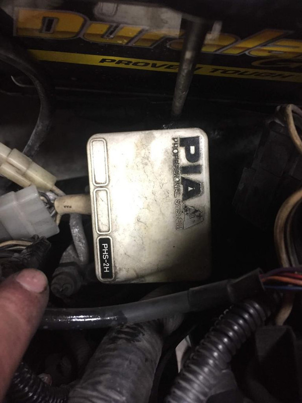

Is this PIAA lighting stock or aftermarket?

I've not seen any PIAA parts on my lighting so would assume after market.

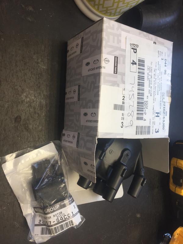

I realized that somehow in my tune-up I forgot to check the cap and rotor.
Popped that off and sure enough it was super corroded. I cleaned up the contacts as best I could for the time being.
This made the car noticeably smoother and quicker to rev but I still get the spark blowout around 6-7K so I'll still need to get new parts.

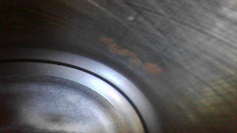

The smoke was getting worse so I started with a compression test.
150-90-150-120    damn.
Wet test, no improvement    damn.
Fearing the worst,

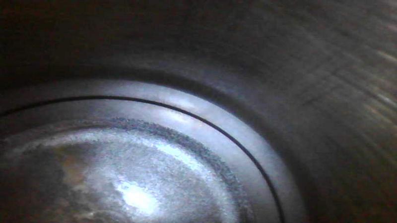

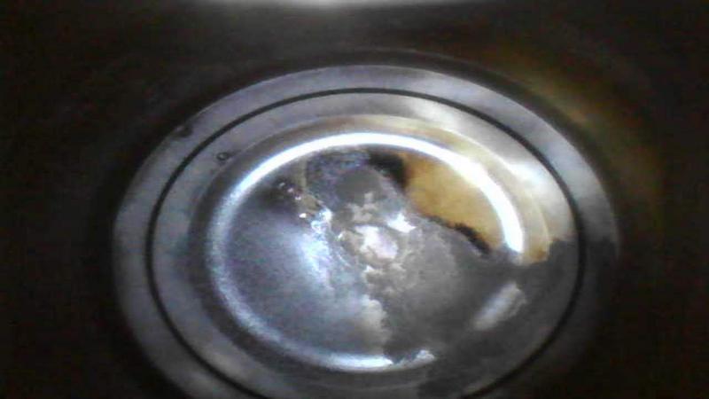

I got out the borescope.
Track Rat - '91 Pulsar  - Page 2 IMG-1371
Track Rat - '91 Pulsar  - Page 2 IMG-1372
Track Rat - '91 Pulsar  - Page 2 IMG-1373
Track Rat - '91 Pulsar  - Page 2 IMG-1375
predetontion marks on all cylinders.
#2 piston looks melted, hence the low compression.
#4 rust pitting on the wall (I assume from sitting for 15 years)
Obviously, that sucks. I'll have to do a tear down now.

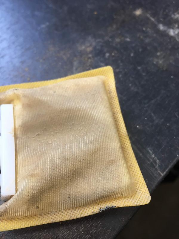

I opened the tank in hopes of a smoking gu.
Track Rat - '91 Pulsar  - Page 2 IMG-1565
Track Rat - '91 Pulsar  - Page 2 IMG-1570
There was some crud on the filter sock and some crud in the bottom of the tank but it just doesn't seem like enough to actually clog the pick up.
What do you guys think? Has anyone seen this before?

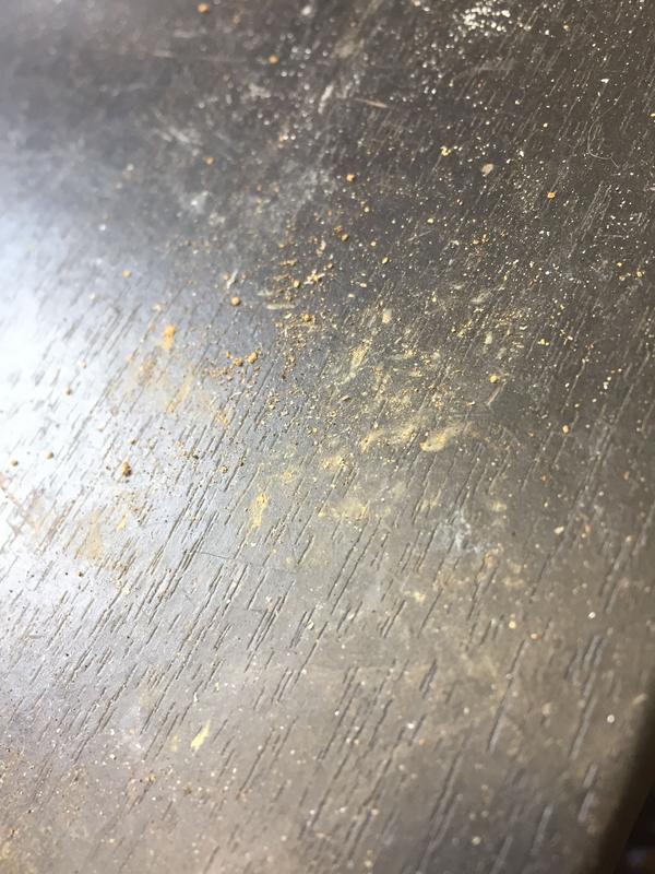

I think I have identified the main issue.
As I said and showed the pickup sock had some crud on top of it but nothing that looked like it stop much flow.
I took the pump assembly and threw it on my bench as I worked on other thing over the last week.
Today, I took a quick look at it again in between working on other stuff, the gas was evaporated and the sock was dry.
I noticed this very fine white powder on top.
Track Rat - '91 Pulsar  - Page 2 IMG-1682
I looked closer and sure enough it is all over the thing.
Track Rat - '91 Pulsar  - Page 2 IMG-1683
Here is some I banged out on the bench.
Track Rat - '91 Pulsar  - Page 2 IMG-1684
I took the sock and tried to blow through it in various spots. Where ever the powder was I could not blow through it at all! (with my lungs not compressed air) Blowing around it seems as though at least 75% of the sock is absolutely clogged.
It seems like that would give me the trouble I'm having.
The fact that it seemed like when I filled my tank it alleviated the problem is the only unexplained symptom. It's possible that when the fuel is pumped into the tank, the flow was enough to "rinse" the sock off a bit and unclog some of the sediment. Then after some driving it would clog back up? Not sure.
So, this leaves me with a few questions.
What caused this sediment?
I cleaned a bunch of white slime out of the tank when I did the fuel pump when I was getting the car started. I heard this is caused by water contamination with ethanol fuel. I've also read that once this dries out it turns into a white powder. Maybe this is the problem?
Second, assuming the contamination is not actively being created and just needs to be cleared out, what options do I have?
I read that dropping the fuel tank on these cars is quite a process. Even then, I'm not sure how I would "clean" all he inner surfaces.
A friend suggested running a pump from the tank through a filter and back into the tank and just cycle it for hours on end to stir it up and filter it all out. Any thoughts on if that would work?
Related note. I need to change my pistons. I got VET piston for next to nothing. I know the GTIR is 8.3:1CR and the VET 9.0:1CR. Anyone know what the VET piston in gtir will yeild? I know GTIR head is slightly lower (8.3 vs 8.5) compression than DET but I don't know DET vs VET. Just curious more than anything, either way I don't think the final CR will be far enough out to cause problems.
