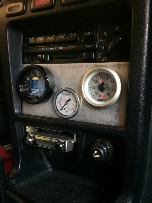

Fitted the other gauges to my pod.
Rebuild Time - Page 2 FE84AD33-FA60-4C39-84CE-D3911D9E8CA4
Should help keep an eye on all things.

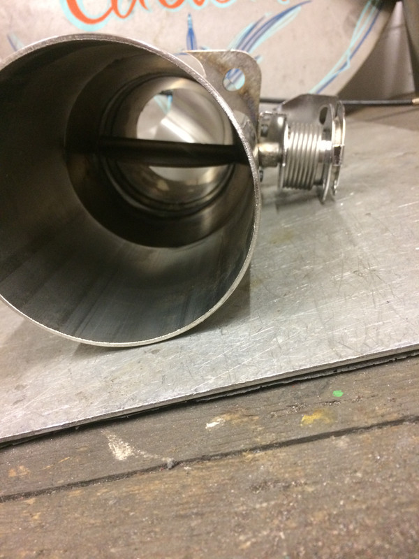

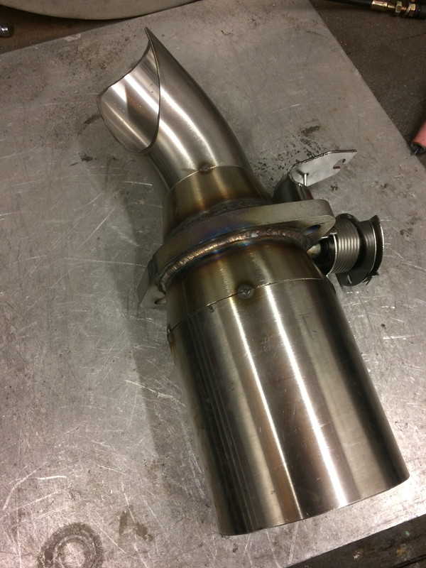

And made some progress with my exhaust mods.

Looks good, the gauge pod looks like pretty tidy and fits well, are you going to black it out?
28Rebuild Time - Page 2 Empty Re: Rebuild Time 24th May 2019, 1:15 pm
Yea just fitting everything up first, then I'll spray it black so it's more discrete Smile

Nearly there with the exhaust, it’s all fully welded, just need to put a couple more hangers on it and connect up the valve cable which will sit next to the handbrake.
The idea being it will be nice and quiet and the gasses will flow through the rear silencer and out of the discrete pipe on the lhs when the valve is closed. Then when the valve is open be nice and loud and take the easy route out of the rhs 4” tail pipe for when you want some noise Twisted Evil
