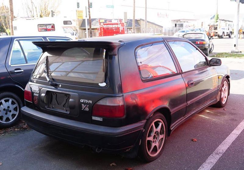

So, I decided to go down and take a look. The ad made it clear that the car was beat down with a lot of "janky tuner mods" and "battle scars"
When we got down there it was clear what they meant.

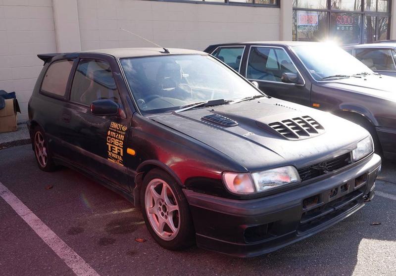

"Track Rat" seemed to be a accurate description. The car looked like it had been "raced" quite a bit. Bolt in cage, a few performance upgrades, race seat, coil overs, and  a lot of electronics tied to the ECU. We took stock of the state of the car. As they advertised, the car had some damage on each quarter, it was filled and then re-damged on both sides. Seems the guy wasn't very good at his racing of choice.It did not run as it sat. Sodo-Moto had only gone as far as ripping out a bunch of excess wiring shenanigans and diagnosing a fouled fuel pump. Other than that they knew it popped when fed some ether.
I knew if I were to get the car it would need to be a runner without extensive work. The owner gave us permission to toy with the car at our will.

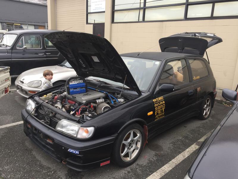

He brought out a cheapo pump and with the tools I brought we had it fired up in short time.
Surprisingly, even after what we guess to be at least 15 years, the SR roared to life. A smooth idle, good compression, boost pressure, some vapor, minimal smoke.
However, lots of lifter noise. Since the GTiR has a solid lifters, they are louder than the normal hydraulic lifter SR's I'm used to but this was excessive. This came with low oil pressure, only about 30psi and not much gain with rpm.
Engine = good enough

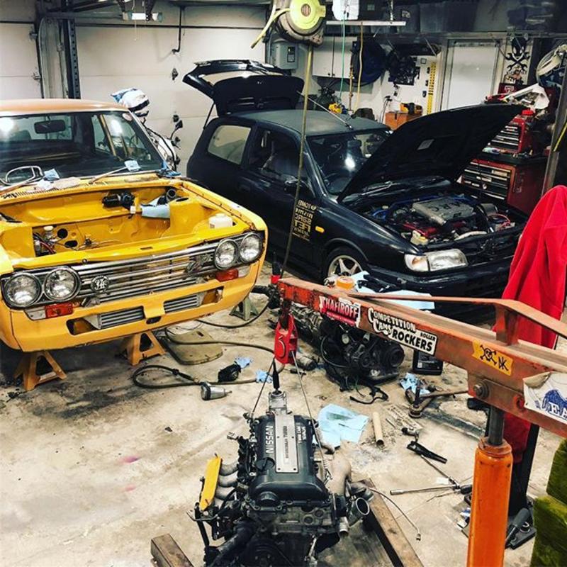

Since I still have my torn down 510 wagon clogging up my only garage bay, my friend Jeff was generous enough to loan me a bay until the car is a driver.
