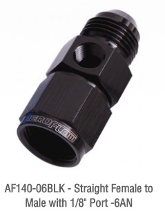

My plan was to use a fitting like this:
power steering switch Fitting213
But i need to use 1/8 power steering switch, as I cant find these fittings any bigger.
Anyone have any recommendations on a 1/8 switch I could use? or any other options? Im running haltech not a factory ECU btw.
